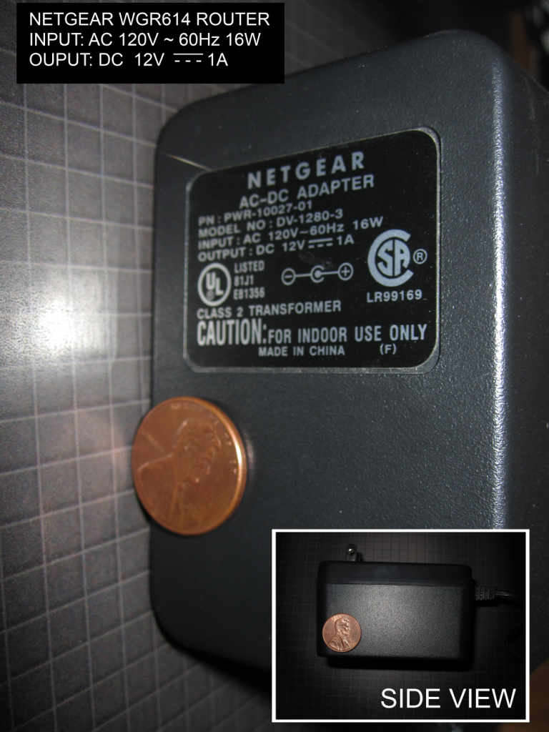

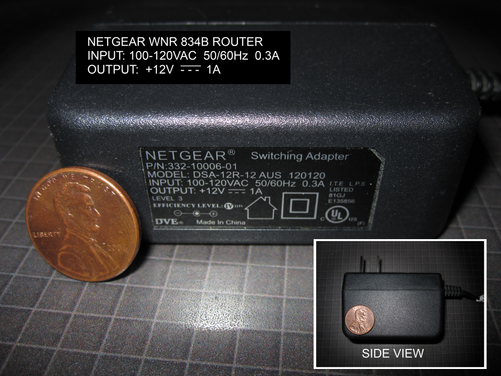

So my internet connection came down earlier today and I went to look at the router. All lights were off. Its a Netgear WNR834B running DD-WRT. I unplugged the adapter from the router and checked it with a multimeter. The speced voltage did not register. I have a older Netgear WGR614 router with an adapter that has a similar plug but its much small and lighter. The specs are the same.
Are these adapter interchangeable? If so, why is the older adapter so much bigger/heavier? I know that there is a transformer inside and it all depends on the wiring, but the newer adapter is considerably smaller.

They are interchangeable. The older adapter uses a large transformer & diode bridge that operates at 60Hz. The newer adapter uses a switchmode power supply with a much smaller transformer that operates at the hundreds of kilohertz to megahertz range. The smaller adapter is also more efficient.

Thanks for the reply PottedMeat. So can these things fail with normal use or should I look into what what may have caused it? It was plugged into a surge protector and everything else on it is running fine.
Also, is it worth buying a new, small power adapter?
They can fail over time. It isn't really an indication of anything. I wouldn't buy a new adapter if the extra one you have works. I'd take that even farther, and say if you have another transformer, but the wrong connector, cut the wire on the failed transformer, and put it on the correctly specced transformer. I save all of my transformers when the gadget it was powering dies, or gets thrown out. I've reused different transformers several times, by splicing wires with the correct adapter to them. Beats spending money, and wasting more resources.

I've only seen the heavy ones fail because they were attached to a device that needed a larger power adapter - i.e. device needs 12V 1A, adapter supplies 12V 300mA. It was probably just a freak occurrence, these things just happen sometimes.
Before you go buying anything make sure the router still works. You can test it with any adapter laying around that matches the voltage, matches or exceeds the current rating, has the same polarity ( in your case, center positive, outer negative ), and the same size barrel connector.
It's not really worth buying a new adapter if you've got one that you're not using in a junk pile.

First, a larger adaptor is not a transformer with diodes. If it was, then excessive voltages would be inside the router. A large supply is an older technology switching power supply. Smaller one is the new technologies due to higher radio wave frequencies, smaller inductors, and less energy dissipation.
Routers typically have a single chip power supply inside to convert unregulated 12 volts to maybe 5 volts. If true, then any adaptor with the same poor, regulated voltage and sufficient current will work fine.

Will any supply work? Open the router. Does it use an industry standard single chip power supply? Then any DC voltage from 8 volts to 14 volts will work fine for that Netgear router.
