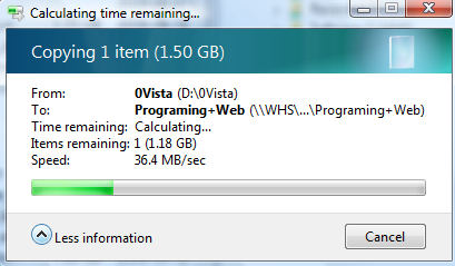

These Depict Regular Peer-to-Peer systems.
Computer with Onboard RealTek 8186 Giga NICs + $30 TrendNet Giga switch, No Jumbo Frames, CAT5e cables.
Regular 7200 Hard Drives that are connected to normal onboard SATA (No RAID) and can Read and Write at 80MB/sec.
As is when installed, Transferring from Vita SP1 to Windows Home Server 2 to 3 GB each of Win7 ISO files.
http://www.ezlan.net/vista/Giga-Default.jpg
After Optimizing both computers TCP/IP to MTU of 1500 and RCwin of 1027840
http://www.ezlan.net/vista/Giga-Optimized.jpg
