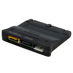

The problem was that even though the drive itself was completely disconnected, the SATA/IDE adapter was still connected via a SATA cable to the motherboard, and it was powered via a 4-pin mini-Molex connecter (see attached photos). Without the drive itself being attached to the adapter, the BIOS and OS were seeing the adapter on its own as some kind of peculiar device that didn't function like a storage device but was powered on and connected to a SATA port. The BIOS and Windows 10 didn't report any error messages, and the only effect was to cause the above delays in the boot process, and the functioning of Windows 10 once booted up was not affected in any way.
