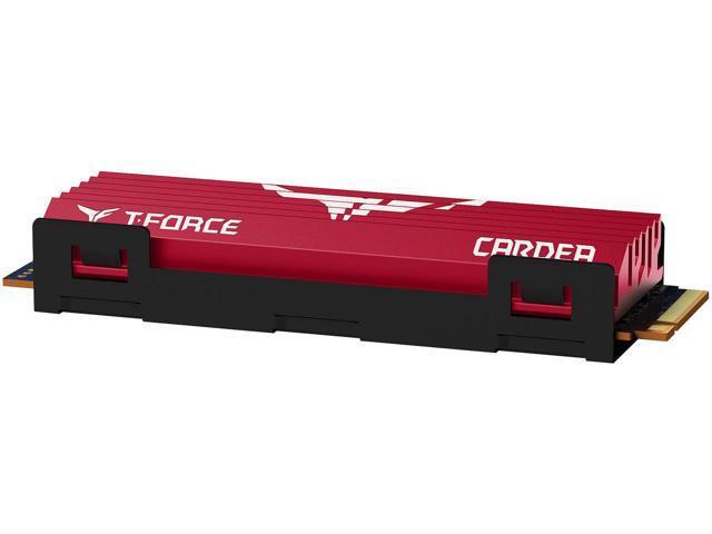

I don't know what voltages are available on the M.2 connector, nor how much power it can supply, or how much heat it can dissipate. (Look at the M.2 PCI-E "Cardea" SSDs for an idea of how big an M.2 heatsink can be, which might also apply to a dGPU implementation.)

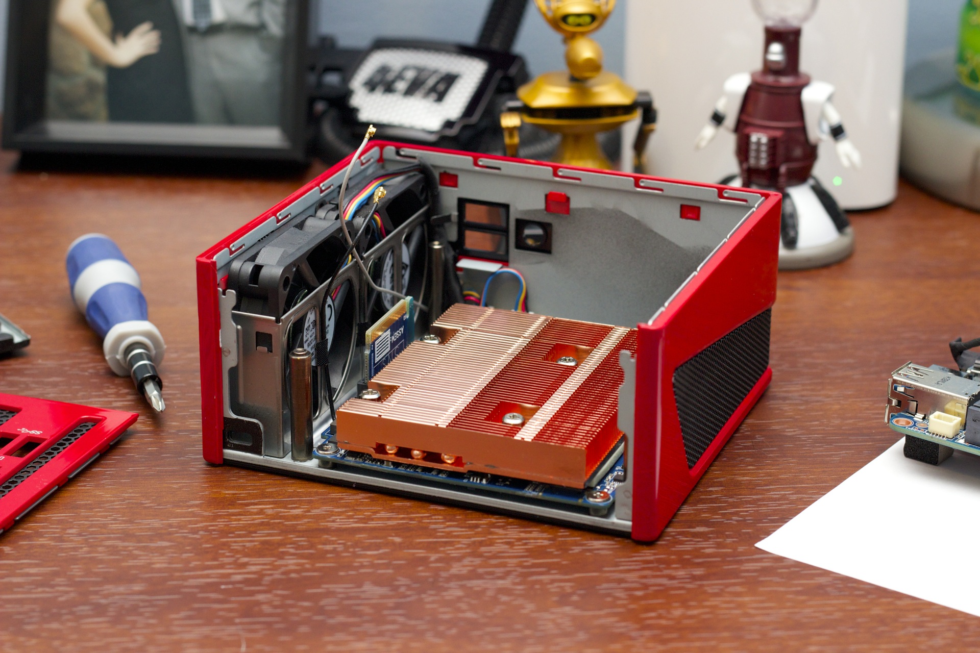

With ASRock's new mSTX small form factor board with MXM GPUs, I think we're more likely to see that become reality than M.2 GPUs.
I think you have a point here, but the markets are different. Or, in other words, this would allow for a reasonably powerful, replaceable dGPU in roughly a NUC format factor. That's a lot smaller than micro-STX. You can't fit an MXM card in a 13-14" laptop without sacrificing a lot of battery capacity either. Of course, I really hope mSTX can get retail sales of MXM cards going. It's about time.
I think the NUC (the specific Intel box) is too small and also somewhat nonsensical for this type of application. Like you said, the heat/power restraints within that form factor are the limiting factor. An M.2 GT 1030 or further stripped 1020 would still be another 30-50W added to the overall TDP of the system, perhaps lower if undervolted/downclocked/golden samples. At what point does the GPU itself become so costly and low performance that the Intel Iris IGP (or someday AMD Vega APU) is the better and more cost-effective choice? I think that BRIX answered that question for us already - those are effectively a NUC with an MXM riser card. How many people have upgraded the GPU in their BRIX...?
Micro-STX appears to be its own market for sure, but realistically it overlaps both Mini-ITX and BRIX by mashing up desktop CPU parts with mobile RAM and native MXM. The hard sell will be paying 200% more for the GPU (based upon $720 for an MXM GTX 1070 on eBay vs $380 for a stubby PCIe GTX 1070). Even a low-end, used 940M MXM is $200 and Intel's top mobile Iris 580 can trade blows with it for less than that. That's the very same hard sell that keeps most people from upgrading their laptops and BRIX units. The only advantage I see with mSTX is greater heat dissipation and the prospect of smaller (or at least differently-shaped) cases than mITX.
