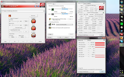

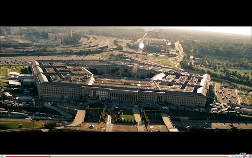

I thought i was crazy, but i've tested this with every media i can think of. I'm getting really poor video quality with my new 4670. Playback is smooth, but extremely noisy with heavy macroblocking and visible pixilation. 1080p H264 content, DVD's, Hulu, Youtube in 1080p and 720p, all behave like this. I'll try and post some screens. I'm running 9.12 betas...668 maybe? Case was the same under 9.11. Any thoughts? I don't have any games on here yet so i can't comment on that, but my 3dmark06 score is about 5200, so nothing wrong there.
edit: so that is NOT a good 3dmark score for the card, i was looking at the 3dmark vantage score. i should be at at least 7k i figure. I've tried rolling back driver to 9.11, reseating the card, different cables, displays, and DVI ports...i think i'll be RMAing the card....anyone have any insight into this??????
edit2: and now after a reboot, i have lost GPU flash acceleration. WTF?
edit3: clearing and reinstalling 9.11 returned my flash GPU accel. poor 3dmark score and video performance stands.
screen shots don't really do the issue justice. an interesting observation i made is that no matter what the video quality, menu bars in hulu and youtube are always garbled. the resolution is very low and in the instance of youtube, you can see the numbers on the right of the menu bar are all messed up..they look slightly better in the screen then they do in practice.

posted some screens in the OP, they don't really do it justice, but all the card parameters seem to be in order.
last 3dmark06 run was 4790, 4384 CPU, 1929 SM3, 1563 SM2. garbage :(

I didn't know they made HD 4670 with DDR2?? This could explain the poor performance in 3D benchmarks but not the funny business with menus appearing garbled. Basically, it becomes no better than HD 4650 with DDR2, maybe a tad faster due to higher clocks.

it seems to me, based on poor video quality, that my card is not outputting the correct resolution for my display. There is nothing wrong with performance of video playback accept for perceived resolution. the 3dmark score, i still can't explain.

I recently purchased a 4670. There are different 4670 cards out right now. Some have DDR2 but most have DDR3. DDR2 cards have less than half the bandwidth of the DDR3. Your screen shot shows 12.8Gb/s whereas the DDR3 cards running at 900mhz get 28.8Gb/s. The memory speeds are anywhere from 800mhz to 1000 depending on who made the card. Some cards have 1gig ram and others have 512mb. I am not sure what games you play but I was able to run Fallout 3 on high settings with with 2x SSAA and 16x AF butter smooth with the $45 card.

WOW. i had no idea the bandwidth difference was so substantial. I apparently did grossly insufficient homework. :D thanks a ton for the info. I'll probably either go with an $80 9600GT or one of the DDR3 4670's. I've RMA'd this thing, asking for a refund. Thanks again.

I solved part of my video playback problem. On my initial OS install, the new flash beta was one of the first things i installed. I reformatted, and went back to youtube before installing the flash beta. Video was perfect. Going to the CPU, but perfect.

the video issue is DIRECTLY related to flash 10.1 beta 1. 10.1 beta 2 seems to solve the issue.
