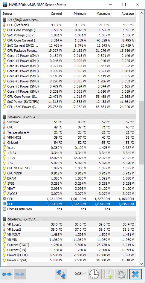

Reviews and posts from people who own non-X570 motherboards:
Below is Ryzen 7 3700X:
I've found a single happy user whose 3700X is idling at around 13W with Gigabyte X570 I Aorus Pro WIFI
