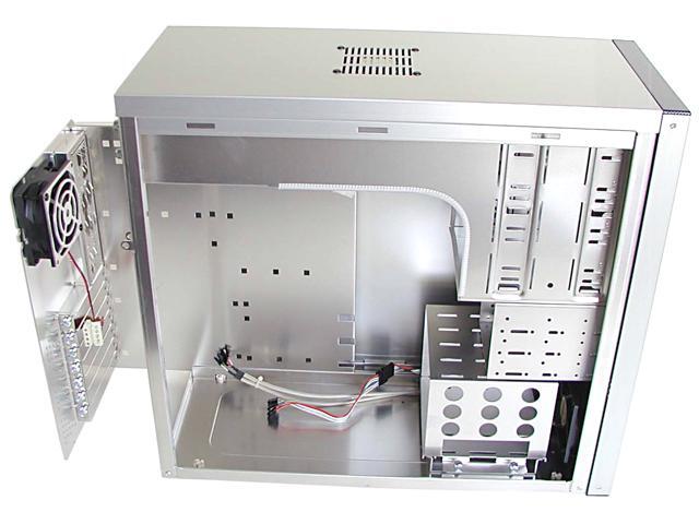

depends...it can help as hot air rises..and intakes tend to be at the bottom front, leaving the top front area a sort of dead zone with hot optical drives etc. then again some cases with built in top exhausts have lousy grills that block most of the flow. i put blowholes ontop of old pos cases that have few options for fan locations in the first place, kinda like the one you pictured. heres a pos case with the fan on the outside, simply because its slightly too cramped to fit on the inside. inside gap exists, just not quite enough for fan frame to fit.

My case has one built in (similar to that one) that I use w/an L1a @ 7v. I could probably get by without it, but I feel warm air above it, so it's doing something.
