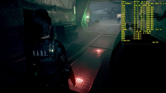

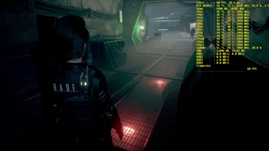

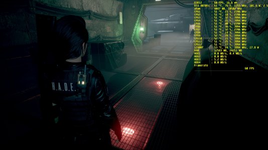

A few more tests if anyone's interested.
Daymare 1994 seems interesting, since it features all, dlss, fsr and xess in all their settings. I am testing native vs balanced, since this is my go to solution. Seems ok to me, for the distance I'm playing.
I chose this scene since it has grates on the floor, some lights, one of which passes through the grates, a yellow/black texture on the door with an angle, some cables, a close model (the protagonist) in the foreground, etc, thought there are quite a few things for the upscaler to resolve.
Native 4k 253W
dlss balanced 94W
fsr balanced 80W
xess balanced 102W
First of all, the upscaled results are really good. Fsr and xess retain more color and dlss seems a little washed out. However it is doing better with the fine details of the grates, if you look in distance. xess is also good with the grates and retains the initial color.
The differences between the upscalers are not substantial and all do a very good job. What IS substantial however, is the 150-170W difference, compared to native. The retained image quality is bonkers, for the power draw saved.
You can see that the 4070ti is almost at its max for 4k native. The significant power draw saved, means that the upscalers, open up 4k/dlss/xess/fsr balanced possibilities, for much lower grade cards and that's why I love them.
Also the vram savings are substantial. Xess in particular, saves a whole 2GB vram in this scene. Actually it goes from 8GBs are not enough, to...ahem...8GBs are enough. xD
I find it weird that Xess is consuming the most power, compared to the other upscalers. I mean dlss is supposed to use the tensor cores and these are not running on air I guess? For this static sceme, Fsr is the middle ground in image quality, power draw and vram savings, and for a purely software solution, son I'm impressed.
However I tested motion in this one too. Here's the vid. Same thing, native vs upscalers balanced. (non monetized channel since 2006)
I am not sure if the video can highlight the differences though. It was recorded with an external recorder, which is 1440p/60 capable, but the recording was done on my 2500k which can only do 1080p/60 without stutters. It then was upscaled to 4k for better bitrate.
Anyhoo, again all upscalers are great. fsr more defined, dlss more accurate but somehow I think xess is the better middle ground.

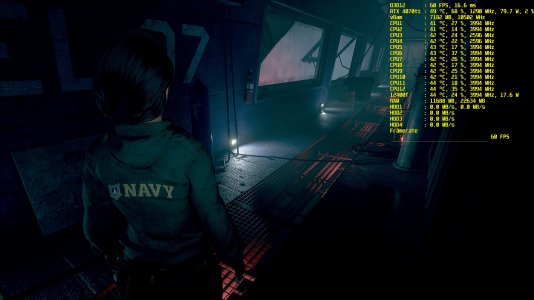

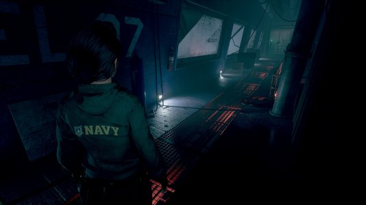

One more comparison for daymare. Native 1080p vs 4k dlss performance meaning 1080p rendering and the upscaled.
native
4k dlss performance
far more detail for dlss and I believe the power draw was the same. I turned off the osd because at 1080p, it was covering everything.

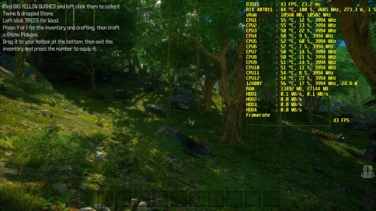

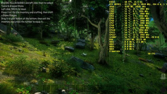

And last but not least, a quick Lumen UE5 test in Karagon. I am not sure if this is the correct thread. I mean Lumen is like UE5's RT solution right? So it's not completely off topic.
Anyhoo 4k native only here.
No lumen
Yes lumen, no performance xD
With lumen the game becomes beautiful for sure. It takes one more Gig of vram and drops the performance to 43fps. The card is at its maxest I have ever seen at 273W. Yeah without upscalers, it ain't gonna cut it.
Also I need to test this on the 6600 at 1080p, to see if it belongs to the 8GB enough yes/no club, but the processing power requirements, kinda suggest the 6600 would have bigger problems than the vram. The 3060ti would be interesting though....

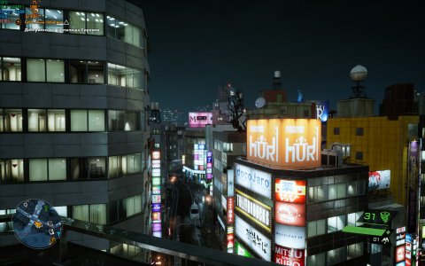

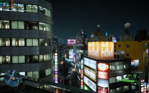

SolidQ
Jul 13, 2023
159
GhostWire: Tokyo
Max setting + RT shadow
Native
FSR1 Ultra Quality
FSR2 Quality
FSR2 > Native > FSR1
I wish if other game have superior impementation like GhostWire
Reactions: psolord

Am I the only one that thinks the textures and the way all of the flora is rendered look like Far Cry 3 era?
Karagon is almost an indie game, from a small dev that also self published. The rendering is quite superior than Far Cry 3. I tested Far Cry 3 very recently and although it still holds its ground very easily, the superior rendering of UE5 shows, even coming from a small dev.
It's the artistic approach and execution, that is far superior in Far Cry 3, due to the immense studio behind it.
There is a demo for anyone willing to give it a try.
You can turn Lumen on and off with an F key. I think it was F5 or F8.

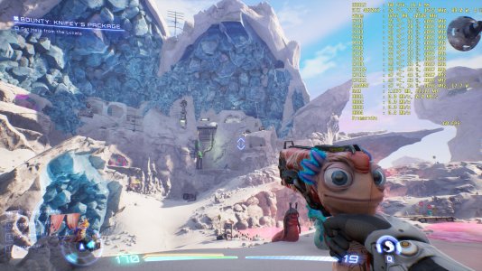

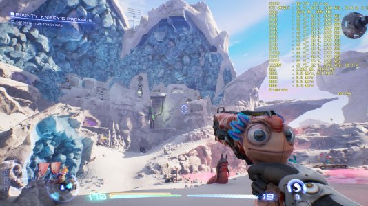

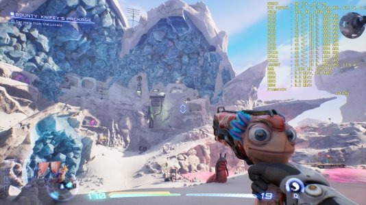

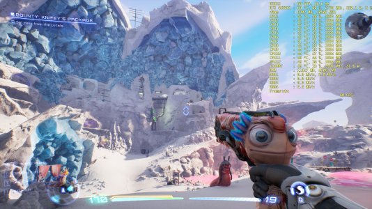

Here's a new test, on High on Life, High on Knife DLC. They added all upscalers, while there were none on the initial release. I had to play the first one at 1440p/ultra on the 3060ti, since it could not do 4k in a convincing way. From what I see here, 4k/60/ultra/upscaler/balanced would be feasible.
Fantastic results from all upscalers. Will try to do a vid next week with all of them. Xess seems to be the best of all. FSR2 again impresses with its low power draw. I mean we are going from 220W to 60W. That's crazy. I swear I don't see the difference from the distance I am playing. I can hear the difference though, as in fan rotation speed!
Vram was not very affected in this one, which is curious. Seems to be ok with 8GBs tho, considering this is 4k. *ahem* xD
4070ti, 4k Ultra preset
Native 4k
4k dlss balanced
4k fsr2 balanced
4k xess balanced
