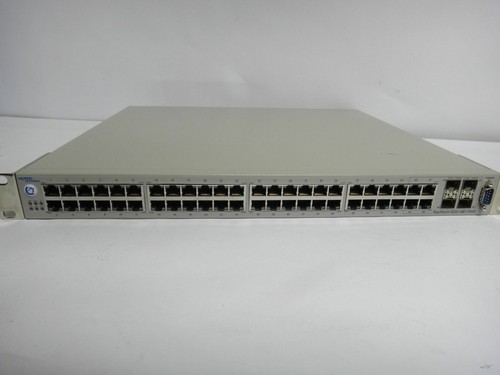

configurable in blocks. I got my Baystack 5520-48t-pwr for like 100 plus tax used. This was quite a few years back, like 2014.
here is one on ebay
another
