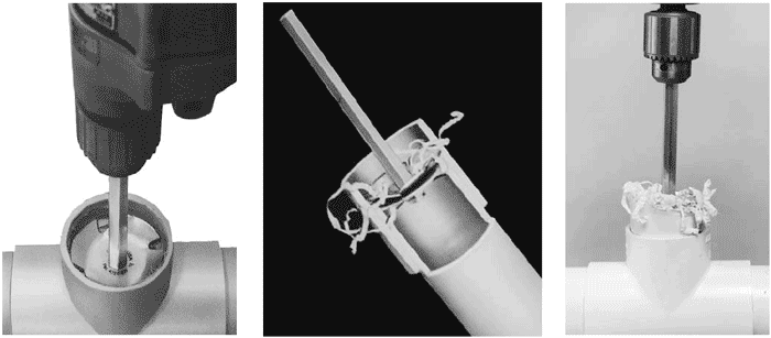

They make a special tool to cut the pvc from the inside. It was shown on a This Old House episode. Once you get it off, just get a coupler and maybe a short section of pvc pipe to extend it up to where the new flange needs to be.
http://www.plumbingsupply.com/rambit-plastic-fitting-saver-tool.html
