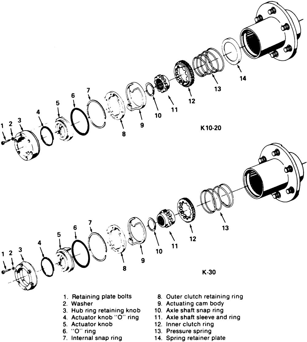

My dad is looking for a schematic of the front axle hub assembly for a 1983 GMC 4x4 2500. I looked in Google and couldn't find anything. If you need more info. let me know. Time is of the essence.

The diagrams are def there in the repair guides and when you select a part.

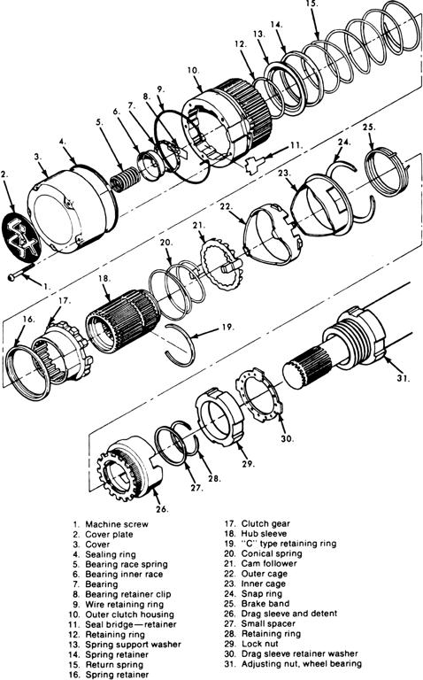

Well I asked my dad if that was the correct diagram and he said the diagram was part time not full time. I have no idea what that means. He needs the full time diagram. I guess there's less parts?

I'm not really a 4WD guy, but, uh, wouldn't full-time indicate that there is no unlocking of the hubs? Thus they should be pretty damned simple?

Didn't know there was such a thing for those trucks. I'll see what other diagrams AZ has.

That might be it. I recognize the washer. I'll ask him tonight. Right now we've had snow so there's not much auto repair work you can do outside.
