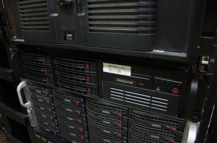

I built a "SAN" (I treat it more like a file server but SAN sounds more cool. :p) a year or so ago. I went with a Supermicro board (forget which one but it was a fairly basic one, nothing crazy) with 8GB ECC ram and a Xeon E3-1230. For the case I went Supermicro 24 bay. Looked into the Norcos but based on reviews and DOAs I decided to skip that and go with Supermicro even though it was more expensive. Redundant PSU was also a big selling point. A file server is not something you want to turn off, ever, so if I need to do any kind of power work I can walk power from one source to the other.
The 4 IBM enclosures are also connected to it via fibre channel, but I don't really use them and they're not even UPSed. Eventually I may even take those out, they look cool more than anything, but the top new server is like 10x better than they are in every respect.
Currently I have about 19TB between 3 raid arrays, two raid 10's and my old raid 5 that I moved from my old server. Goal of this server is to host all data but OSes. Any other server or machine on my network has a SSD for OS drive and that's it. No hardware raid or nothing. Just cheaper and easier to manage. For raid I use Linux mdadm raid. I find it's the simplest and has been rock solid. I am interested in BTRFS too but it's not considered stable yet.
Recently added a new VM host too: (the big box above is my old white box core2quad server with 8GB of ram, still running lot of stuff which I need to migrate)
That server has 32GB of ram using a Supermicro board and SSD for OS. CPU is a Xeon E3-1270. I long debated between E3 or E5 but the E5 platform is just so expensive, for the same price I can build two E3 based boxes, so eventually I'll probably do that, build another.
It runs ESXi so can't do much in terms of migration (not willing to pay for something for home use). I really wanted to go open source but none of the solutions fit my needs, they were just too tedius to use and user unfriendly, or just plain flaky. I may eventually write my own using libvirt as a backend, at that point I'll want to build more boxes to use as a lab.
Now when you start having this much equipment you want adequate power outage protection, and you may even want to have your stuff running for more than 2 minutes as you will start to rely on things more. That's when inverter-chargers come in. Skip the UPS and get one of those and some 100AH+ marine batteries. 100AH marine/RV batteries are best bang for your buck per AH.
