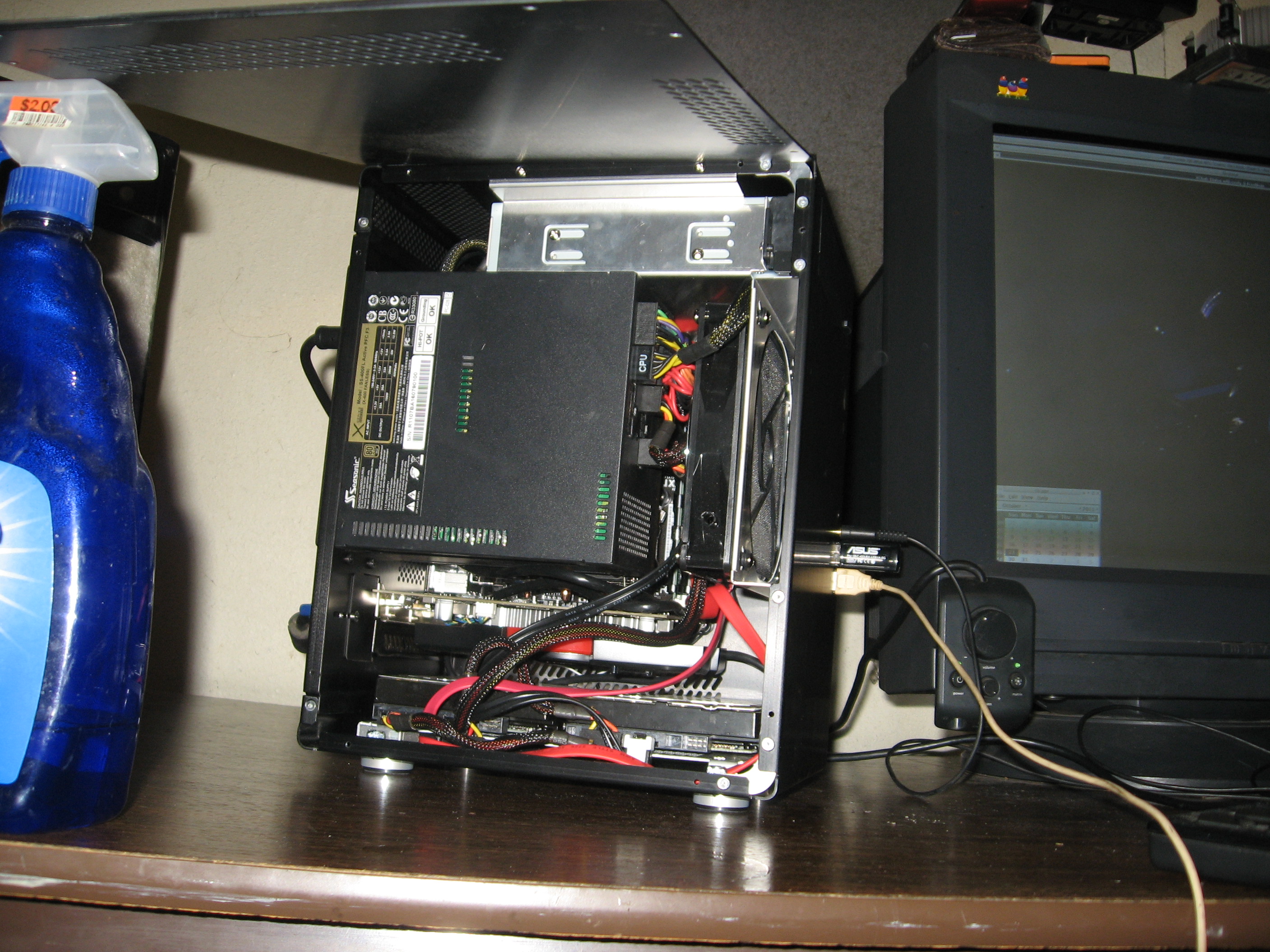

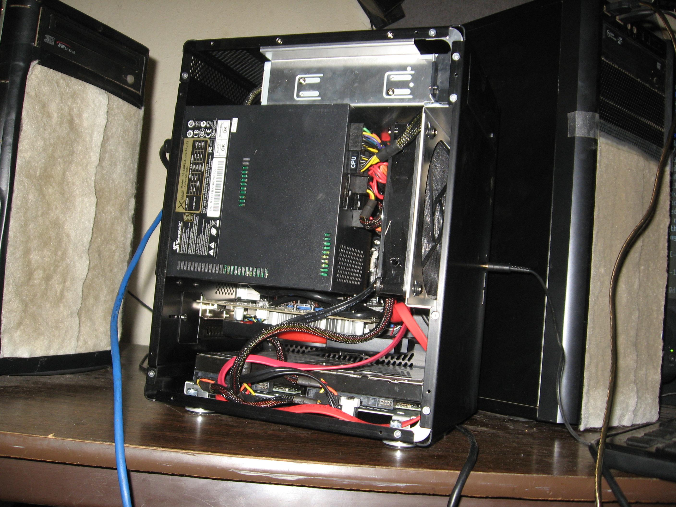

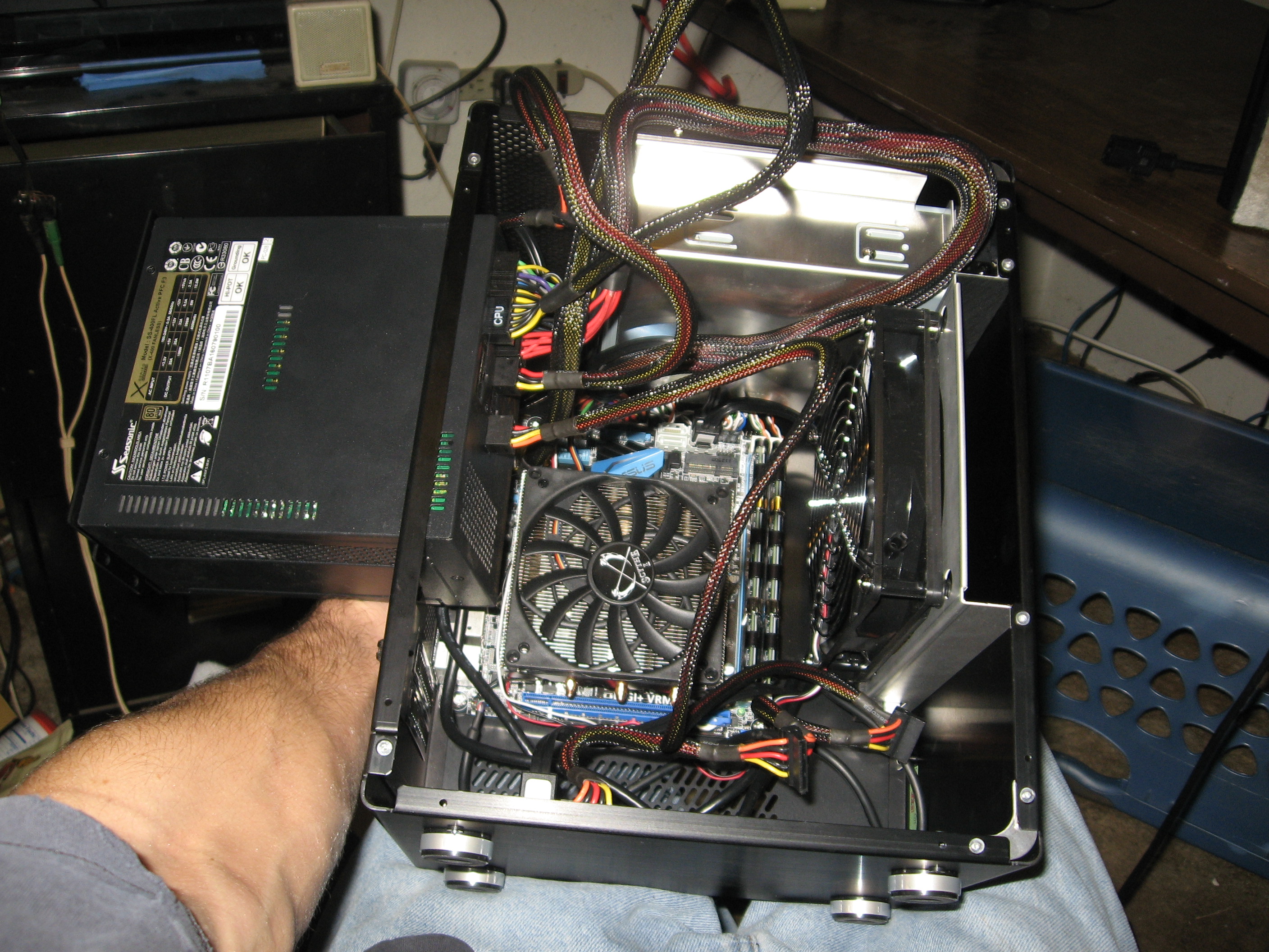

I have a Q11 and am thinking about building another one as I love this little case. Curious how the Seasonic fanless PSU fit.

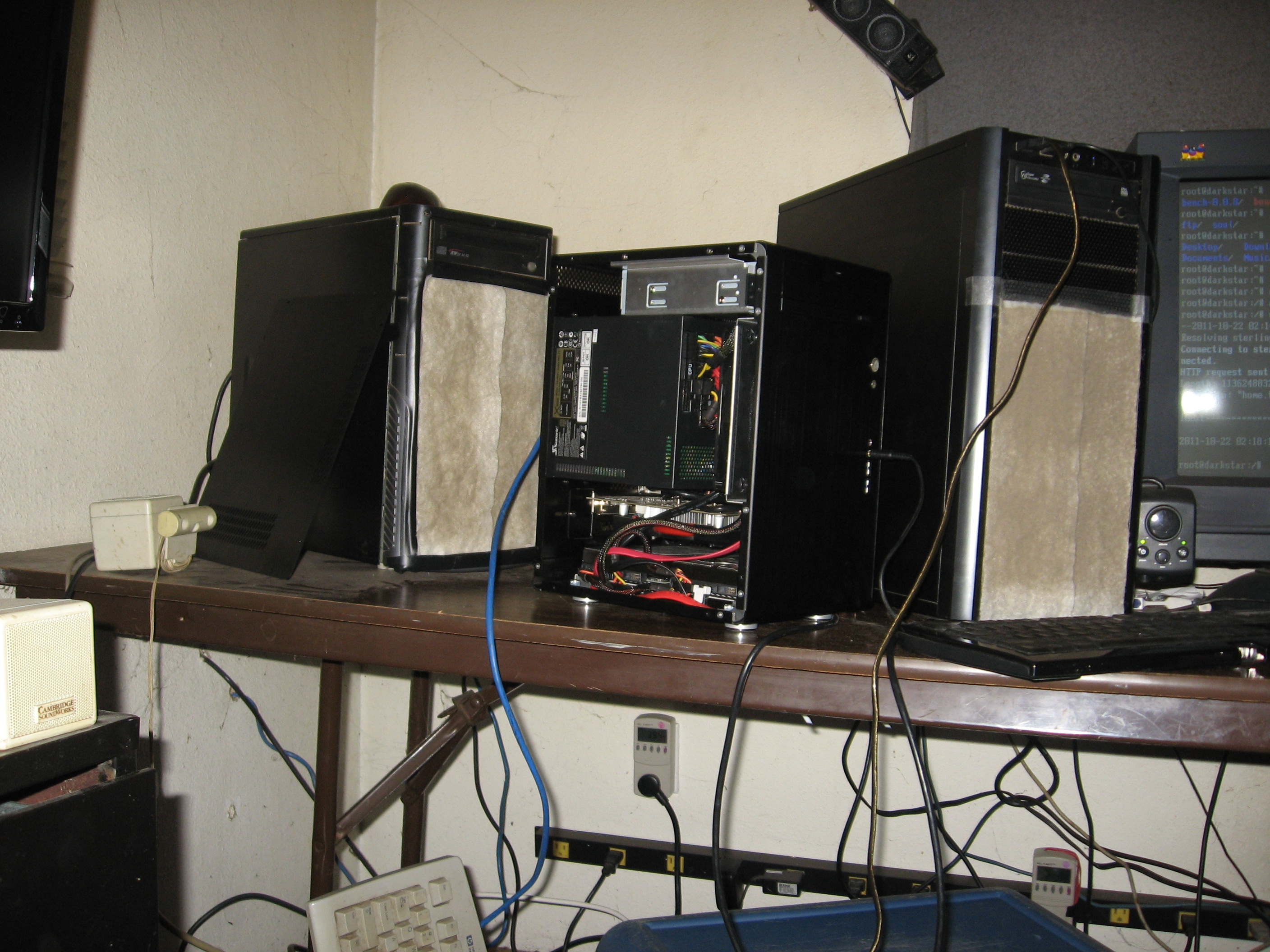

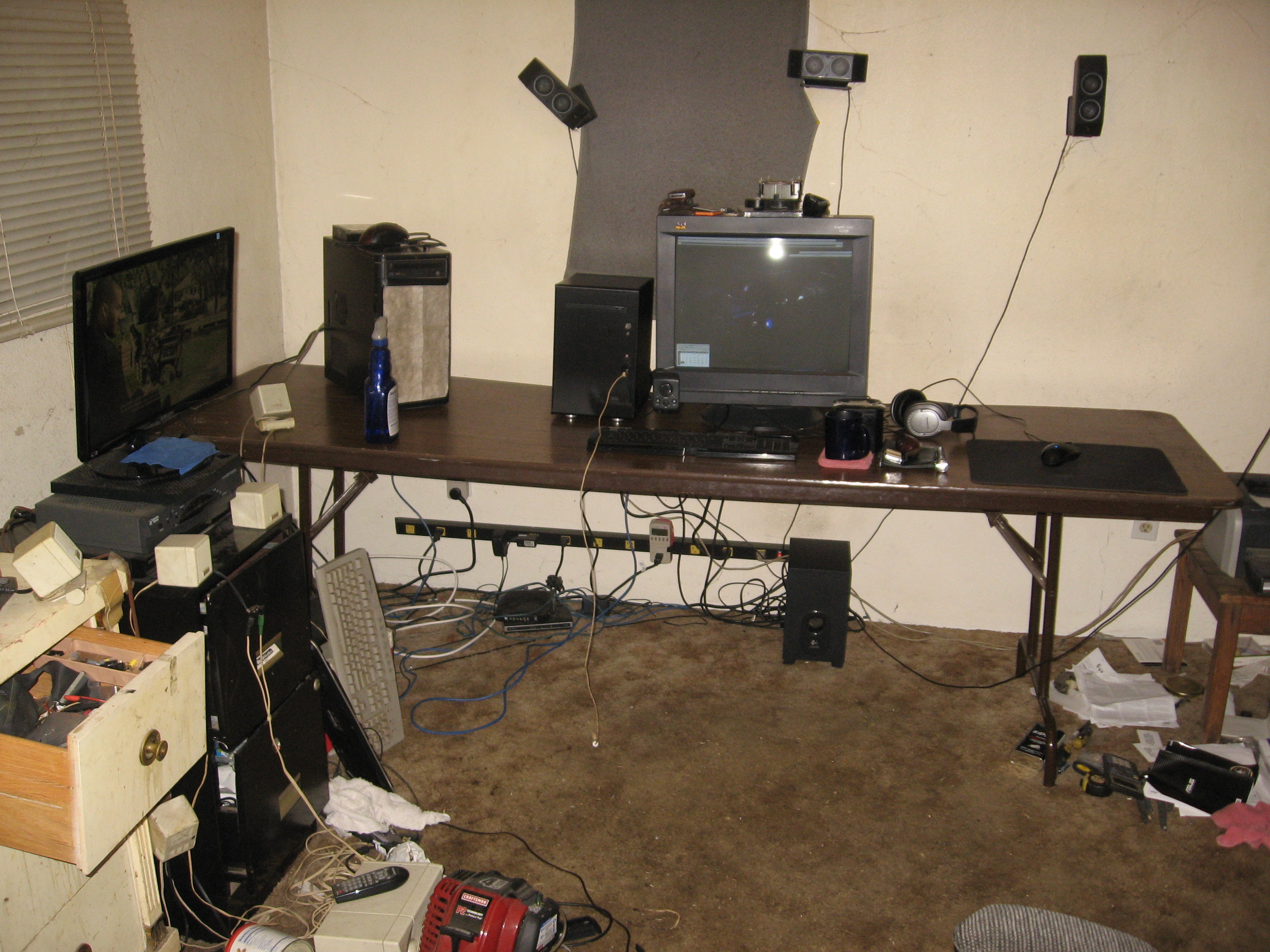

Wow, your work area looks kind of ghetto. What's with the cover over the front mesh of that other case?

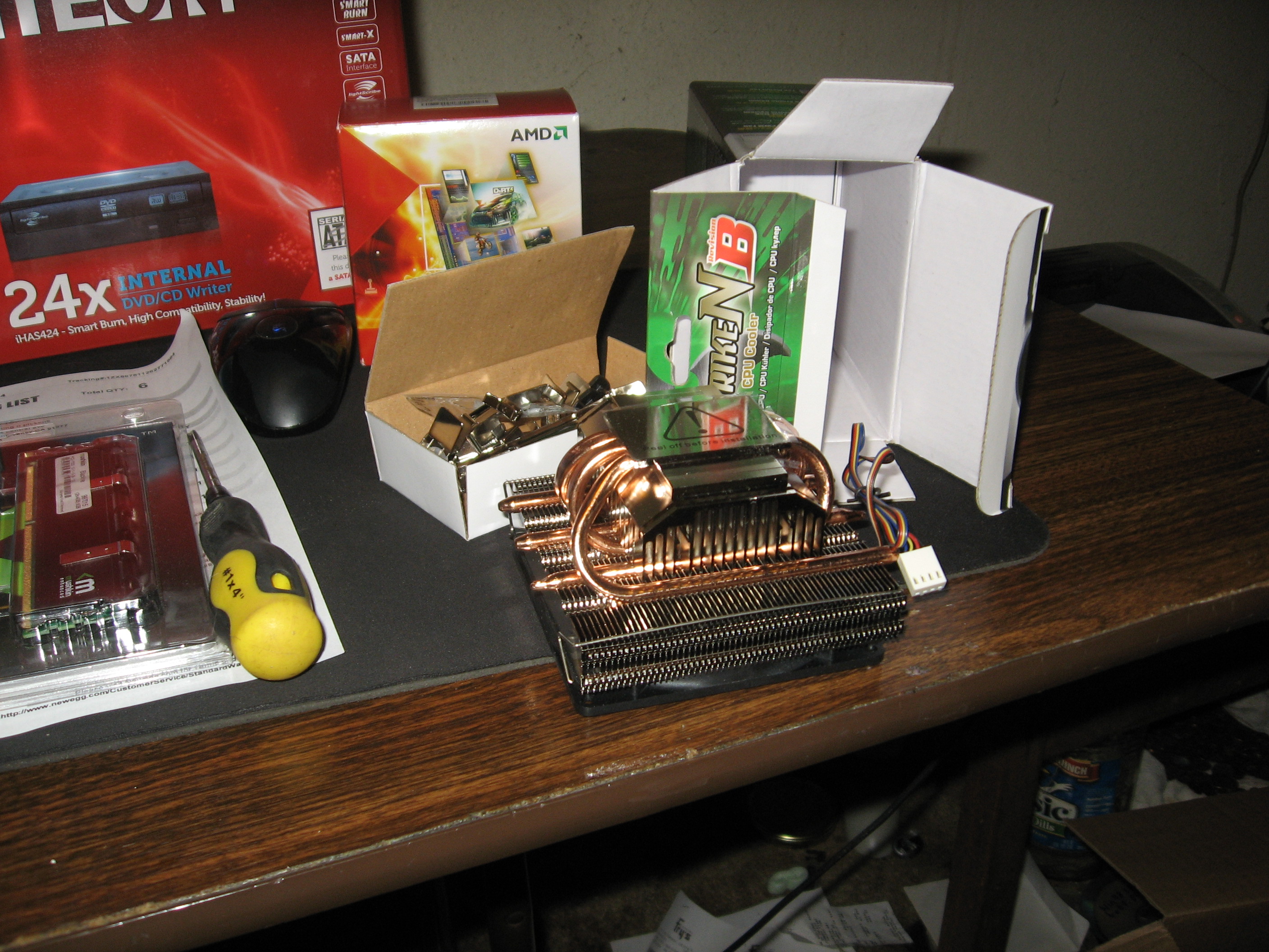

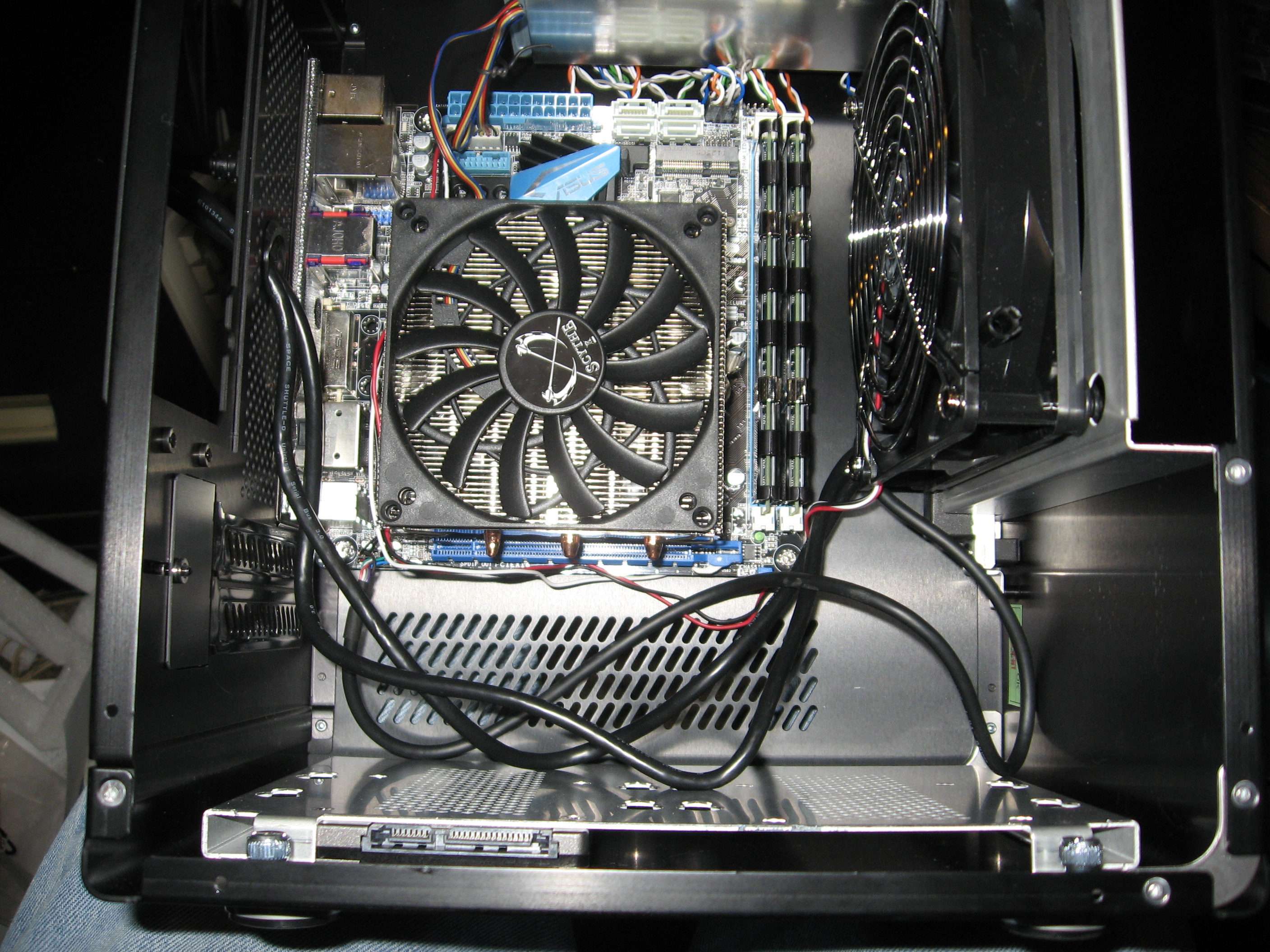

What modifications did you do to the HSF to get the video card to fit?
Since only the heatpipes connect the upper heatsink to the lower heatsink, I was able to put it on the edge of the table and apply a good 25lbs of force or so causing it to move the upper heatsink a good 15mm parallel to the bottom one.
I blame asus for this, they put the socket much too close to the pcie slot
The HSF is surprisingly light feeling
electro-static vent filters over the intake (they need replaced, been washed too many times)
just taped on because I didn't feeling like unscrewing the bracket I made for it every time I clean the filters.

It looks like you flipped the PSU? Is that because one of the fans would otherwise be butt up against the side of the case? I had that problem initially, but I drilled a pattern of about 20-30 small holes in the side panel to get air flow instead of flipping it (which would have created airflow contradictory to the CPU hs/f). Then my Corsair PSU died the very first time I started it up and my backup PSU didn't have a fan in the same place, making those holes pointless...
the PSU is a fanless seasonic, it's oriented with the open mesh pointing down.

Did the heatpipes bend or do they pivot to the new position?
