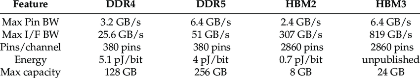

We are in the process of figuring out which memory option would be the best for our needs. What are our requirements? Very simple
1) Bandwidth: BW TB/s, say greater than 20TB/s
2) Capacity: C TB, say 20TB
Aim: Which memory technology can meet our demands at the lowest power? And it is alright if the power numbers are not extremely accurate
Memory Options:
1) DDR5
2) HBM3 or 3e
3) LPDDR5
There are two ways to go about calculating the power:
1) Using pJ/bit: How much energy it takes to fetch 1 bit from the memory and then multiply it by the total amount of data you want to fetch
2) Avg Power: Find average power numbers, say for a single DIMM of DDR5 and multiply it by the total number of DIMMs required to meet the capacity and BW requirement i.e max(BW/(Single DIMM BW), C/(Single DIMM Capacity))
The main challenge: finding reliable power numbers either through the internet or even simulators.
For example: As per the paper here, following are the energy per bit numbers
whereas, if we check the youtube video here, they provide avg power for different operating clock frequency, using which I get around 19Pj/bit number.
I understand that pj/bit numbers vary highly with the operating frequency and even the capacity of the memory macro.
My question to all the experts and enthusiasts is: How do I go about getting a good enough estimate for the problem above and what numbers to rely upon?
