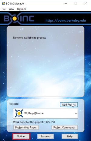

Registering for Yoyo and attaching the project to your computer: Towards the bottom you'll see "Add Project" like in the picture. (Note that you might not see anything in the stuff below that since you haven't attached any projects yet.)

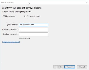

Step 3.2: Creating new account
Enter an email address and password. Confirm the passwords match and click next.

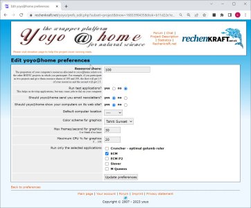

Step 4: Setting ECM and ECM P2 Only
You need to login to the yoyo@home web site with the email and password you created above: https://www.rechenkraft.net/yoyo/
Then go to this link: https://www.rechenkraft.net/yoyo/prefs.php?subset=project
Match the screenshot:
Click update preferences.
