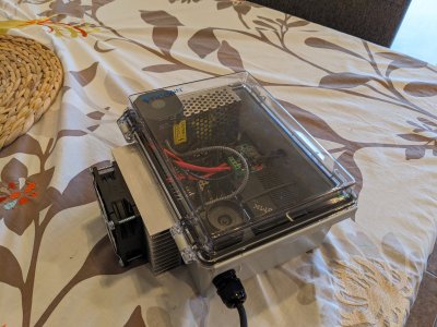

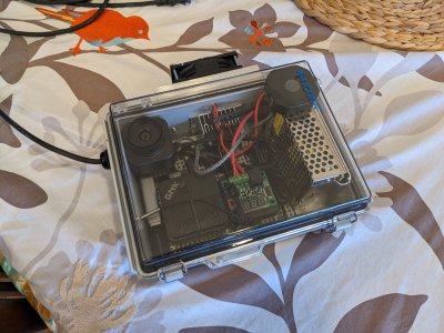

Okay, so this is a weird one. I'm creating a weatherproof live streaming / time lapse camera with a mini-PC inside an enclosed box. I figured there would be heat issues, but my first attempt didn't include any additional cooling and...as you guessed, the enclosure overheated and the CPU throttled deeply. It was too slow to encode the live stream.
My second attempt at cooling involved a Peltier module cooling the air inside the box. This helped, but ultimately there was too much solar load on the box (even when it's 40-50F outside) and it still overheated. I had to put the 12V DC power supply inside the box which added more heat than the CPU so it was counter productive.
My next phase is to construct a custom water cooling loop using the same Peltier module. My question to you is....do you think I can get by with JUST the Peltier to chill the water or do I need an additional radiator to cool the water?
My plan is to use JUST the Peltier (a 60W module) to cool the 10W heat load of the CPU and not have any water to air radiator. Do you think the 10W heat load will overwhelm the Peltier?PXL_20230312_161242237.jpgPXL_20230319_004334292.jpgPXL_20230318_015627137.jpg

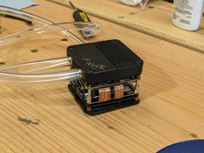

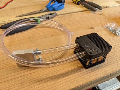

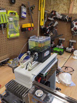

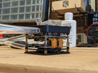

Okay...so I spent pretty much all day working on the custom water cooling loop with the Peltier cooler and it actually works. CPU temps are about 30C with a 100% load (10 Watt). The temps used to shoot up to 85C and then the CPU/GPU would throttle and the performance would decay to the point of being unusable.
I used a 20x20mm copper heat spreader directly on the CPU die and then a 40x40mm aluminum water block. The copper heat spreader was needed to raise the water block because there were adjacent components slightly higher than the CPU die.
I'm really happy with how the water block on the computer came out.
I can now do live 1440p streaming video + a 4k still camera for a time lapse project. The GPU only goes to about 65% load.
I actually have the Peltier and water pump under Volted so they are using about 43W instead of the rated 60W for the Peltier. That seems to be enough and I know efficiency tanks as you increase the Voltage.

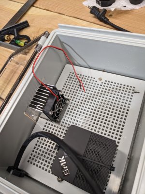

That's what I had originally. It didn't work. There was too much solar load warming the air inside the box. The 12V power supply for the TEC was adding a lot of heat too. Maybe it could have worked if I built it inside an insulated box or something.
That was the best/cheapest pump solution I could find. I was hoping to have it inside the box, but the packaging was too tight to make it work.
Yes, I realize this is a silly project in its end state.
Here is a picture of the original TEC air cooling setup.
