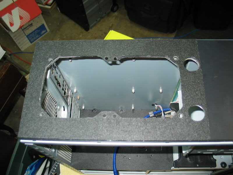

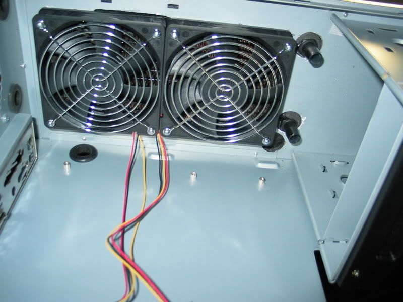

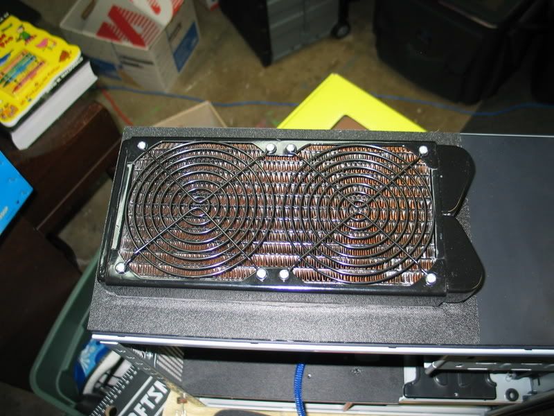

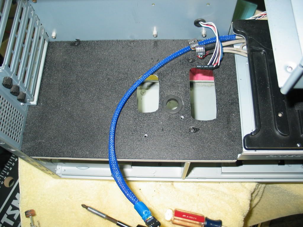

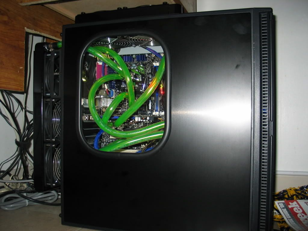

Case closed with window This pics shows Swiftech coolant additive that I've since replaced as well as a different motherboard (Intel BadAxe2).
Motherboard area floor
Cutout for Swiftech MCR220
MCR220 mounted on top
Inside looking up at MCR220

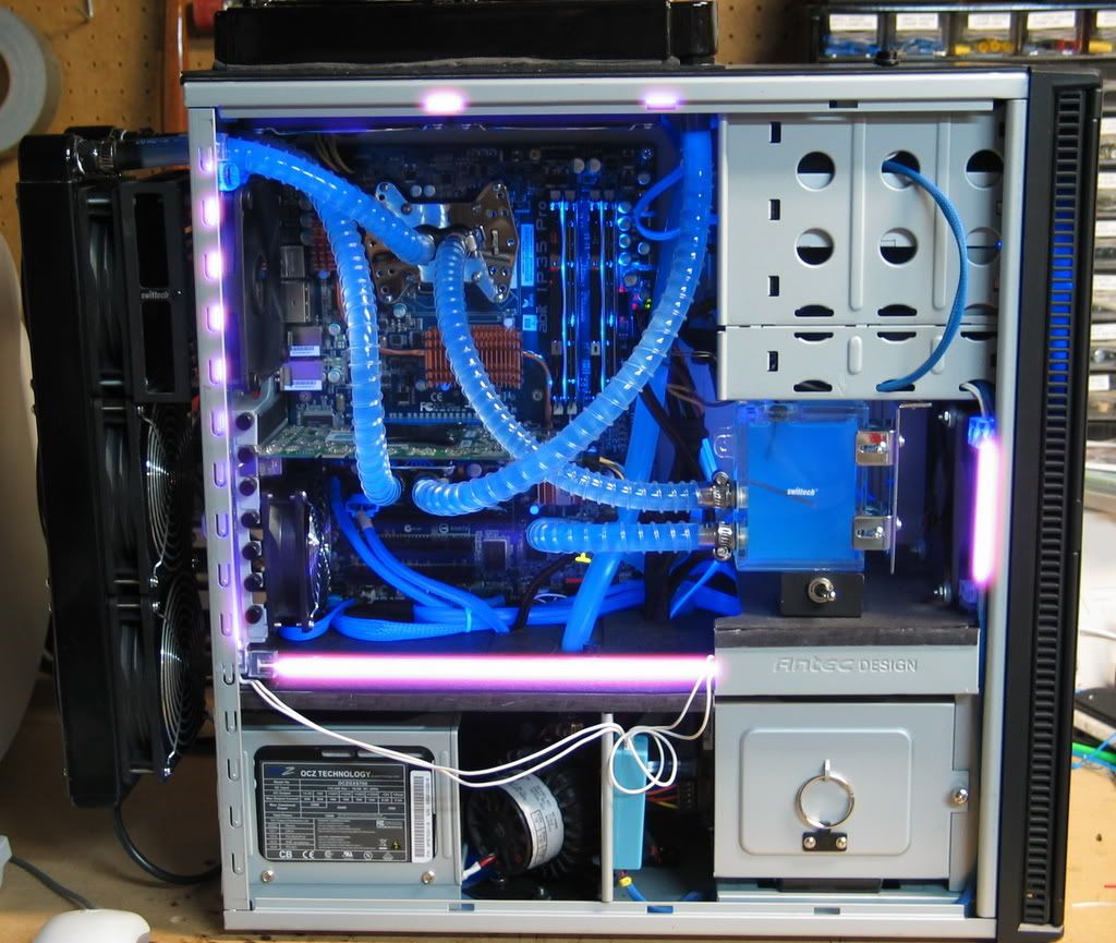

Rig in its current configuration In this picture, the coolant additive is Pentosin G11 (Blue) with blue UV dye (UV lights are on).
System specs:
Abit IP35 Pro / Q6600 @ 3.0Ghz on Swiftech Apogee | 4 GB Ballistix | EVGA 7900GT on MCW60 | MCP655 Pump | MCR320+MCR220 Rads | Scythe S-Flex SFF21F (x5)

Here's some pics from the build.
Leak Test
Leak Test 2
Getting it inside the case
The Loop
My ApogeeGTX w/ Cu Top
My EK-FC88GT
My Pump Placement. No more bottom fan...
Almost finished.... needs cabling and hdd drives in. Lights are on though...
Lights!
I'm not organizing this build too much cuz I'm going to migrate to a P190 soon with new hardware. Right now it idles around 28-32C. Loads around 50-55C. OCed to 3.2GHz (400*8) @ 1.46v BIOS, 1.41 Windows, 1.37 load. My 8800GTS G92 idles at 31-32C @ 780/1950/1000 (2000DDR). I haven't tested it's load yet.
And I by accidentally bowed my ApogeeGTX...
And I hate my 680i SLI. Asus P5E3 X38, here I come!
NOTE: The new EK-150 Rev 2 Reservoirs still suffer from cyclone effect.
NOTE2: EK Highflow barbs leaked on my ApogeeGTX Cu. I had to use the 1/2" barbs included with the block.
