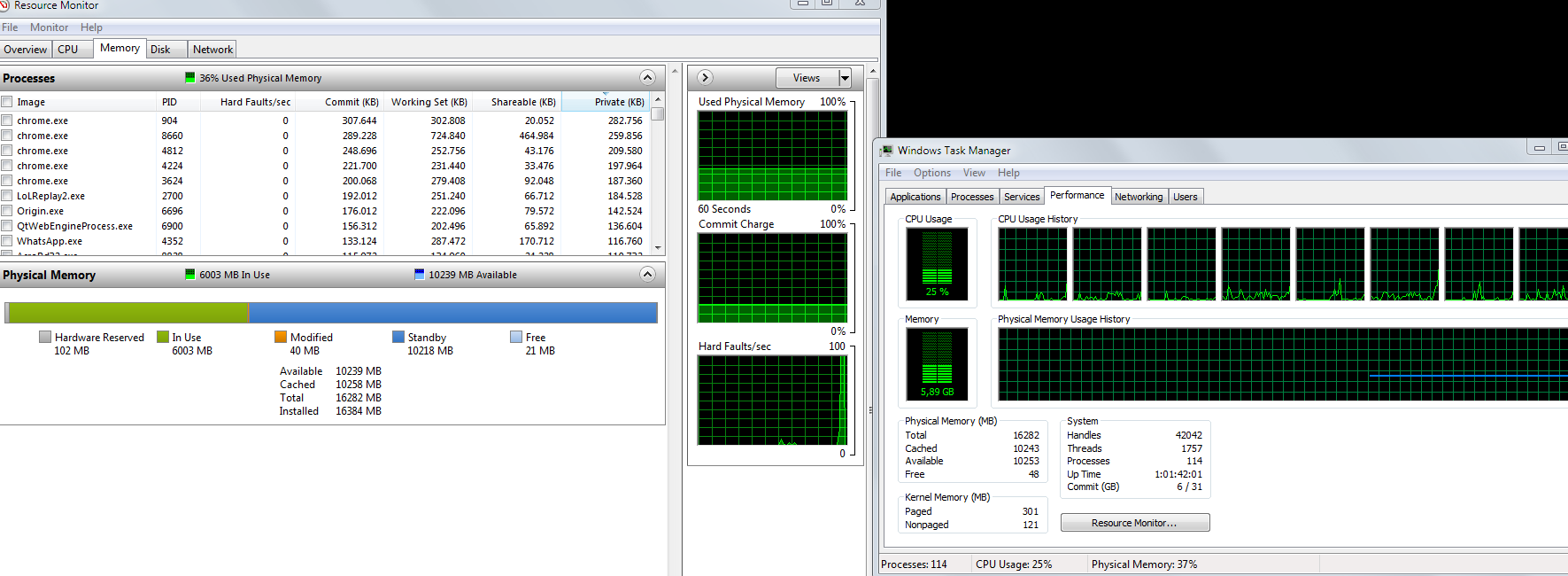

god damn, it started lagging now like crazy, DO I JUST SEE WHAT I SEE AND THINK IT'S NOT NORMAL???
cached - 10,2GB, free 21MB is that it? after restart I'll confirm
https://i.gyazo.com/0c3c243ab9673feef5fd0e2e80de60b2.png
EDIT: nvm that's f-ing normal :/

That's definitely not it. You have ~10GB of physical memory available. That it's "cached" and not "free" just means that you have an operating system smart enough to not let that capacity go completely to waste. Cached memory is cleared on demand by the operating system, and in practice is free.

I don't find anything out of the ordinary in those screenshots, though why is the CPU at 25% if these are idle screenshots? Monitor disk activity.
that's actually a good question, I had multiple tabs open, but I check now, even so I have 1-8% and if I run video it goes 8-16%, after I wrote the thread and chillin a bit chatting with ppl, I go back to video, run it and no stuttering... I really have no friggin idea
Probably a momentary spike - looking at the CPU history, it was fluctuating quite a bit. It looks slightly high, but nothing that would concern me. Bad timing for the screenshot would be my guess.
Next time you experience stutters, please show us a screenshot of the 'disk' tab in resource manager with the 'disk activity' and 'processes with disk activity' parts expanded.
