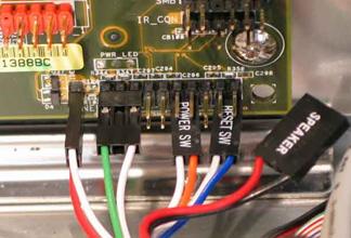

everytime i push the power button in the front it wont turn on. i have to reach to the back and click the I/O and then it turns on.
how can i fix this problem?

Double-check all the connections/plugs, and verify them in the mobo manual. The mobo connections are not always the same.

do you mean the system panel connector ?

Verify those connections via the manual. The power and reset plugs look like they're in the right spot but reversed.
Also, why aren't you using the Q-Connector that should have come with the mobo?

its working now. you were right , the reset and power was reversed. yet the pc was still working i am wondering.....
