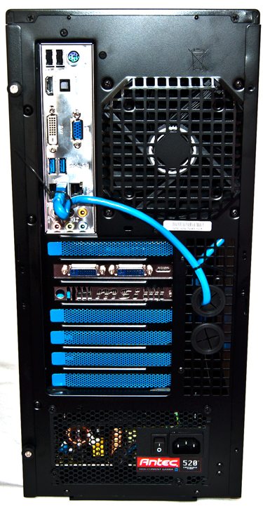

I'm interested in painting the expansion slot covers (brackets, slots, covers, etc, has a ton of names). I was thinking of blue. Just looking for general opinions on this, what paint to use, and how to do this (ie prep, sanding, etc necessary?).
A bit brighter than what I want there.
Here's my case, it's still being put together and it's heavily modded, still cutting things up so it's not put together yet:

Nice hobby .. It's really bright .. Consider lighter colors ..
