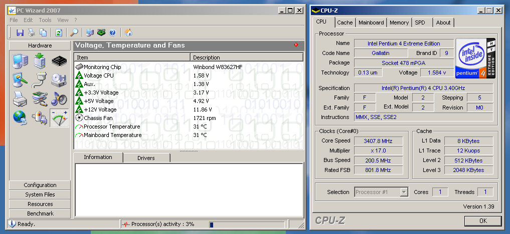

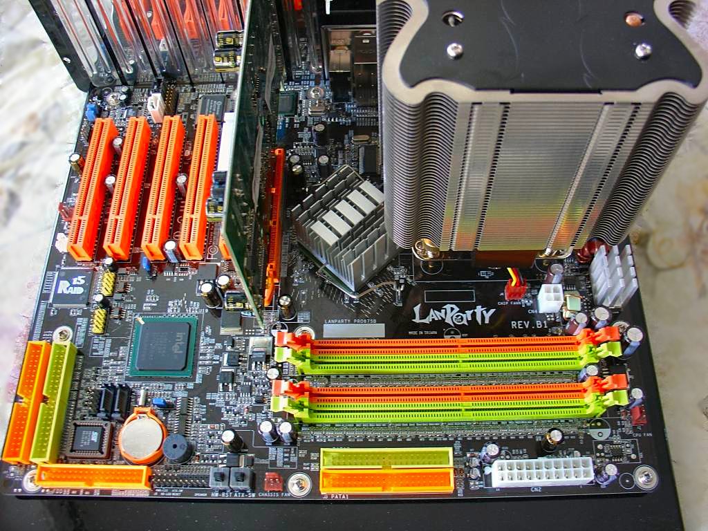

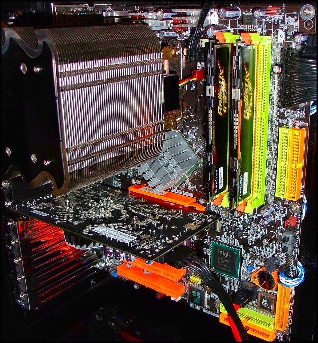

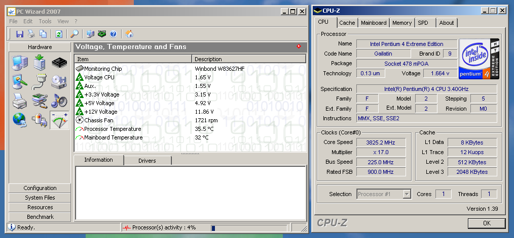

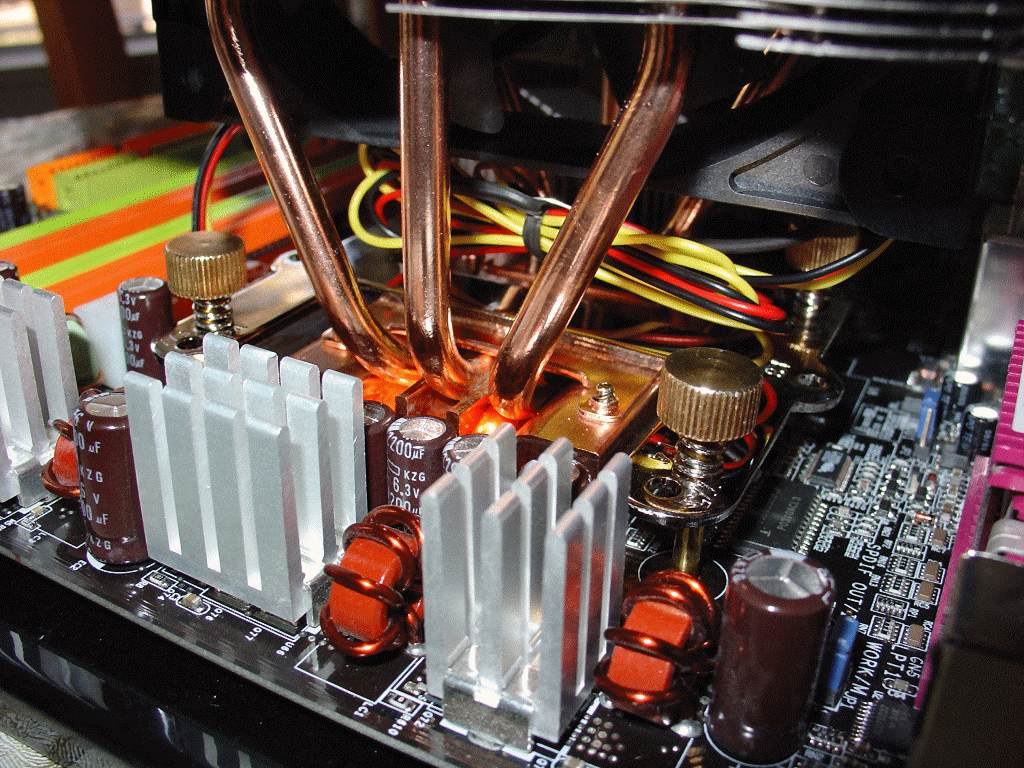

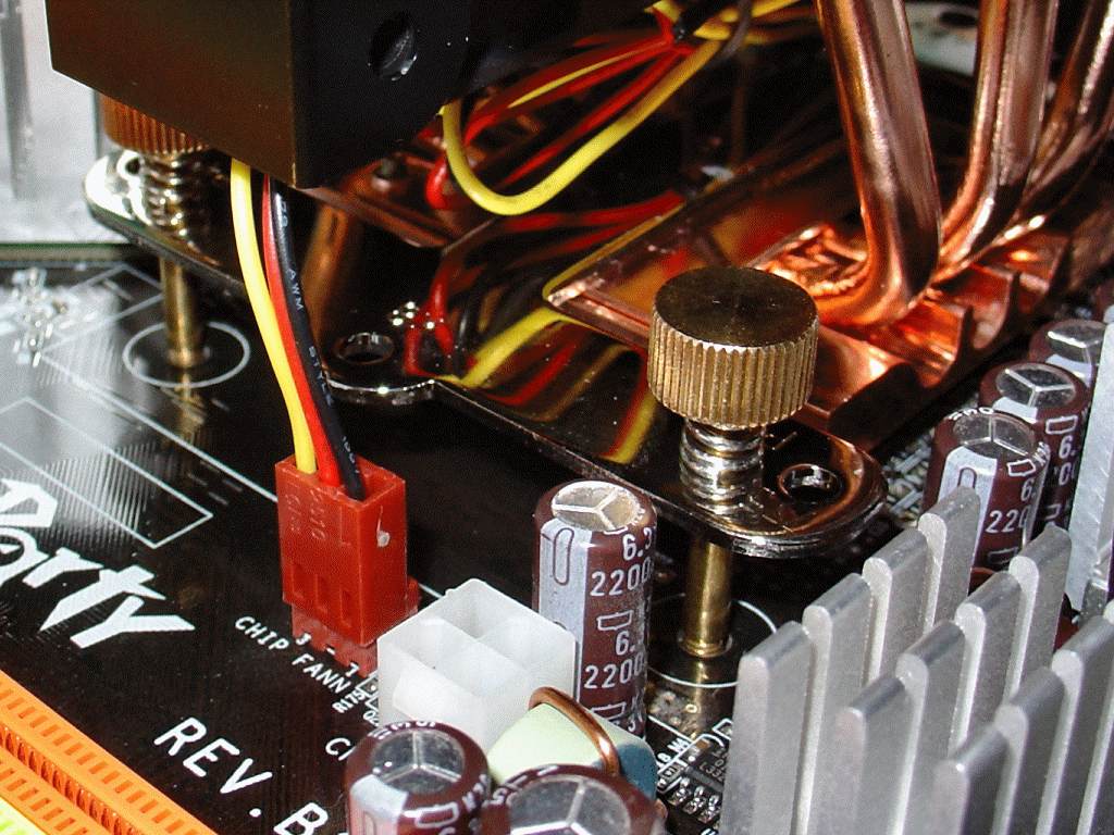

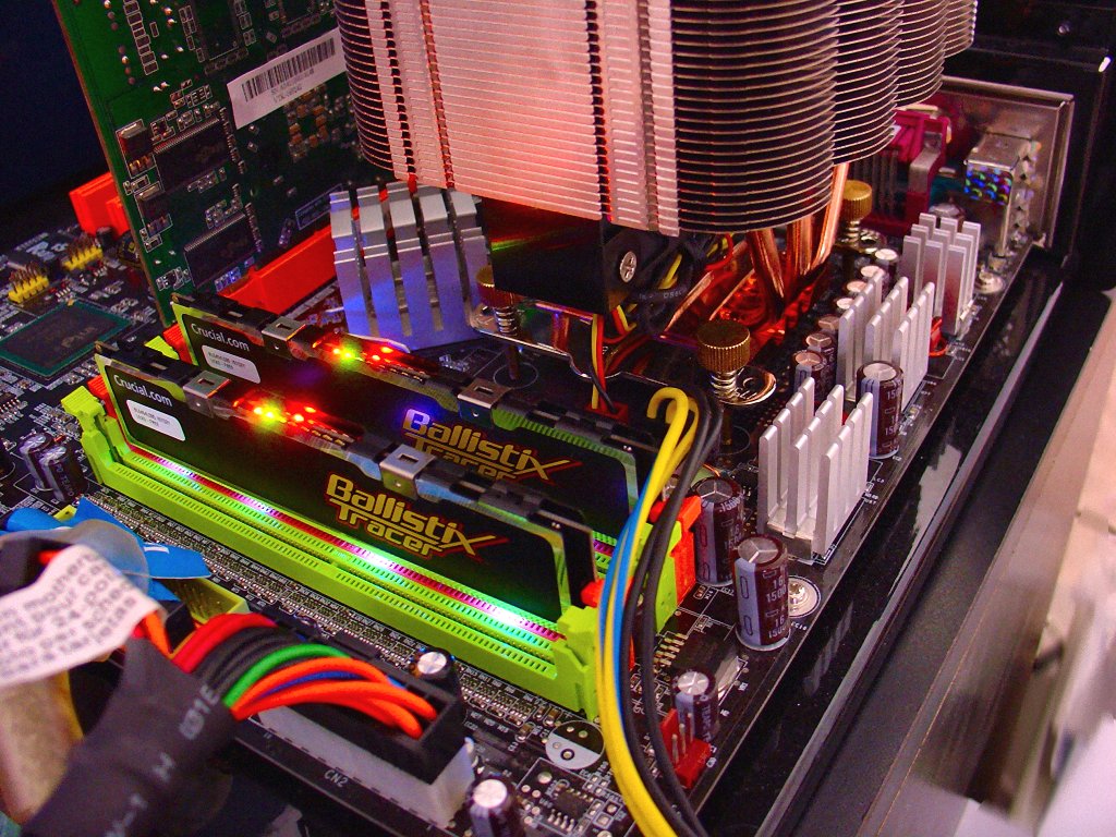

Originally posted by: Ages
Can someone recommend a good P4 Northwood cooler?
Look at "Vin's System Rig" in my sig. It's basically the same genre as yours, but DFI vs ABIT...
I've OC'ed my P4 EE Northwood to 4 GHz (3985 MHz) using a Tower 120 - runs benchmark stable @ 3.8 GHz (3825 MHz)
As far as size/fit goes, while Tower 120s are big, they sit really high off the mobo - so, there's plenty of clearance where it counts! ;)
Here are some purdy pics...
  1. PIC 1
    PIC 2
    PIC 3
    PIC 4
    PIC 5
    PROOF
    TEMP 3.4
    TEMP 3.8
  1. PIC 1
    PIC 2
    PIC 3
    PIC 4
    PIC 5
    PROOF
    TEMP 3.4
    TEMP 3.8
Those are some great pics of just what I need! Looks like I'll have to take my mobo out to mount the brackets but it will be worth it. Thanks a bunch! :)
