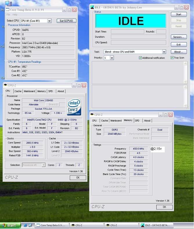

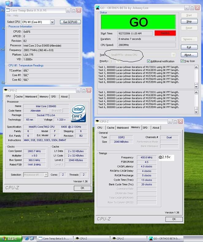

Thanks for your input. I've been scared to raise the voltage on the memory any higher. But if it's safe I'll give it a shot. After experimenting and learning quite a bit in the process here is what I was able to get. (This is before reading you reply)
http://img.photobucket.com/albums/v636/jhh979s/idle.jpg
It would boot at 2.1v w/4-4-4-12 timings but I got errors.
Here is at load.
http://img.photobucket.com/albums/v636/jhh979s/cputest.jpg
I'll try increasing the voltage on memory later.
I did not have time to finish the 3dmark test. That is just what I observed.

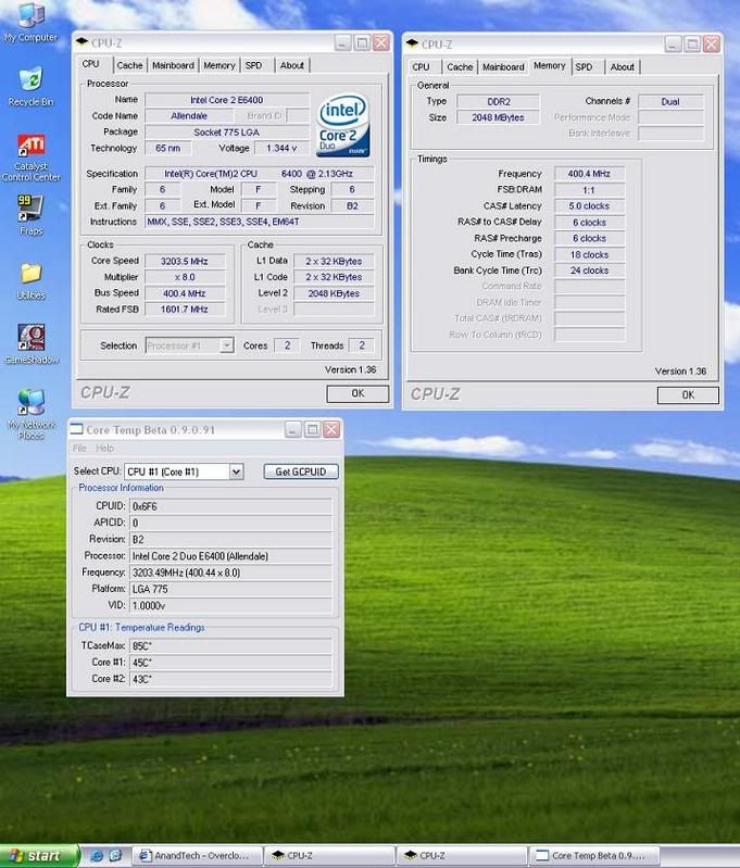

Here's an update. Figured out a few things from the link. Have to set DRAM timings to auto. Booted into XP with 400FSB @1.35 vcore, 4:5 divider @1000MHz 2.2v. But system shutdown during Orthos blend test. I'll try 1:1, as I still think my memory may not be up to the task.
jhh979s
Sep 13, 2006
188
I've tried 5-5-5-15, there seems to be some trouble with the BIOS still. Once you take the FSB past 370, you have to enable the "DRAM timings by SPD" setting or it will not post. Sucks, but I'll have to live with crummy timings for now.
With the 2nd OC i got a 3dmark score of 4959, which seems to be decent after looking at others scores.
