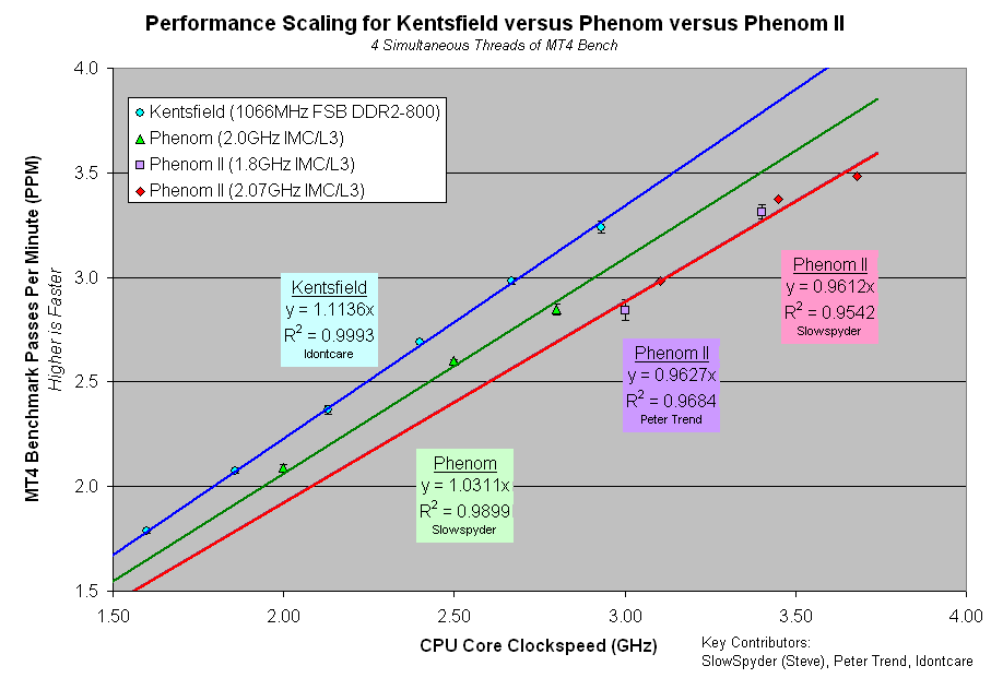

Absolutely, provided the contributors don't mind. Here is what I have accumulated so far:
http://i272.photobucket.com/al...arisonwithPhenom-1.gif
Note that both SlowSpyder's and Peter Trend's PhenomII results are plotted separately (same CPU, different rigs though) but the best fit line for both sets of PhenomII scaling results actually overlaps so well that you can't the purple best fit line which is underneath the red best fit line.
Yes this graph shows PhenomII has lower IPC than Phenom for this particular application, which in turn has lower IPC than Kentsfield. Slowspyder and I are at a loss to explain why this is this case but our current working theory is that the application loves L2$.
To determine whether this hypothesis is true we are hoping to add some Yorktown results (increase in L2$ should result in higher IPC) and some i7 results (smaller L2$ should result in lower IPC).
Another interesting observation as Slowspyder led off with OP is that the uncore clockspeed of his PhII needed to be 2.07GHz to match the results seen with Peter Trend's 1.8GHz uncore...the primary delta in their system's (from what I could tell) is that SlowSpyder is using Vista64 whereas Peter Trend is using regular 32bit Vista.
At any rate this is very much a real application, Metatrader is a forex platform which allows one to optimize their trade algorithms by way of backtesting historical data and then filtering (rank-sorting) the results as a means of extracting the set of parameters which delivered superior results on historical market data. (the usual caveat applies - past results are not indicative of future performance, etc etc)
So for me when I look to make computer purchases I am looking at the price/performance for a rig that delivers the highest number of "passes per minute" per dollar. More passes per minute means less time I have to wait to get my greedy hands on the next set of optimized parameters, with which I hope to increase my quantitative trading profitability.
At any rate I'd venture to guess there are at least tens of thousands of users of this program globally, maybe hundreds of thousands. It matters to us to get results sooner instead of later and for some of us it also matters to get those results in a cost-efficient manner. I've got an aging fleet of Q6600's OC'ed to 3.3GHz that I'd like to be able to justify replacing, so far I have not been able to generate a compelling argument to do that yet.
(my apologies Steve in advance for adding all this background content to your thread, please folks pm me with any further questions you may have so we avoid derailing Slowspyder's thread on the merits of OC'ing your uncore to maintain some "balance" with your core's need for L3$ bandwidth)
