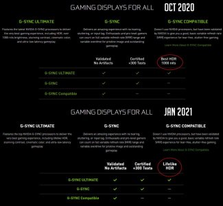

It's just a monitor certification. Part of the G-Sync and G-Sync Ultimate certification, require the NVidia module. Just because a monitor isn't certified, and lacks the module, doesn't mean it can't match the specs. Especially like here with two otherwise identical OLED panels.
There has been some confusion about what the certification means, there is some discussion here:
As I mentioned before, they greatest difference G-Sync is management of LCD Overdrive with VRR, in the link, they mention "Variable Overdrive".
