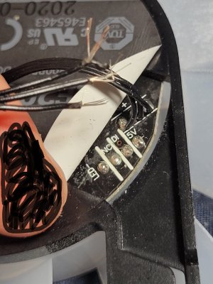

OT Just a question. I have a MF200R ARGB Fan that the wires snapped from the main connector on the center of the fan. Its a clean cut. I was wondering how hard would it be for someone to solder it who has only seen others do it but has never done it himself?
Its just 3 wires, I feel like it should be pretty simple no? I found a small jewelry I believe 60 or 80 watts solder pen I think I am going to buy because Its cheap. And Also I don't know how thick should the metal spool I buy should be?
If you guys could give me some pointers? Its just a small experiment for like $15. If I can repair the 200mm FAN then its good! if not it was a fun experiment but a little guidance would help.

Pics? It SHOULDN'T be too difficult, but pics of the job would help.

Sorry it took this long had to do something View attachment 84168View attachment 84168
You'll have to back-trace where each wire connects to the motherboard, what it's assignment is...5v, etc...don't want to fry things by connecting the wires in the wrong place...and Coolermaster support MIGHT be able to help with that. Otherwise, the basic solder work doesn't look too difficult.
you mean each of the 3 wires correct? not every single wire wire cause each of hte 3 black sleeves has like 30 little wires
I honestly don't think its worth the hassle after all. I think I'll just spend $30 and buy a new one.

Those wires should be easy enough to solder, I would just melt the existing solder and stick wires back in, should be good enough.
Having a cheap pen around is nice for "in the field" but I would highly recommend a proper solder station too, that actually lets you control the temperature.
