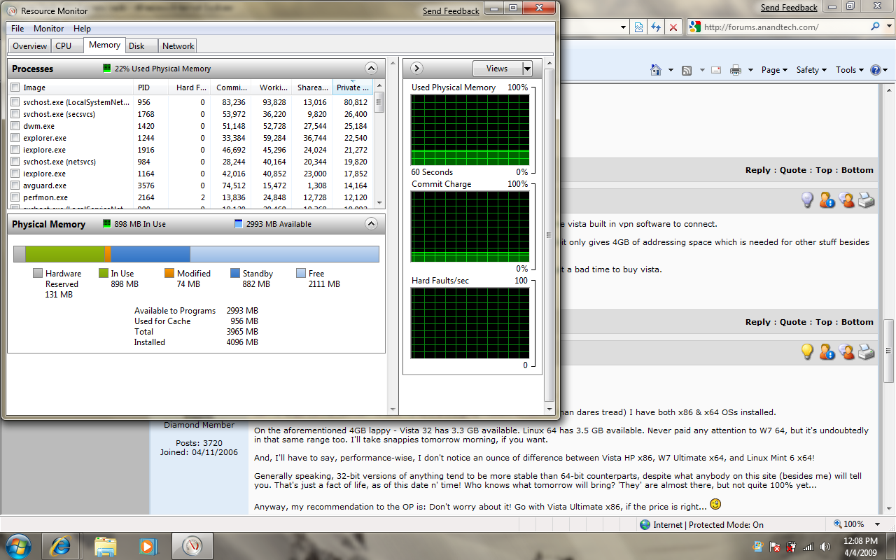

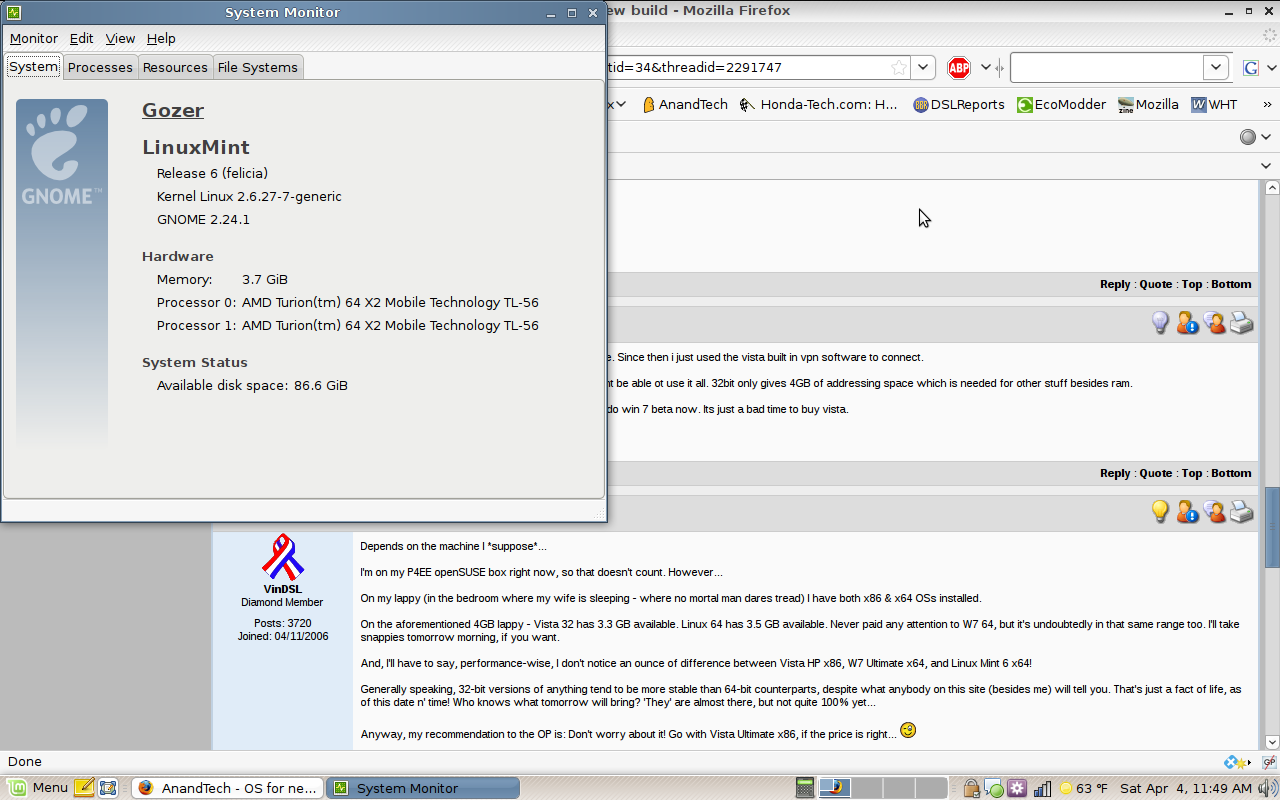

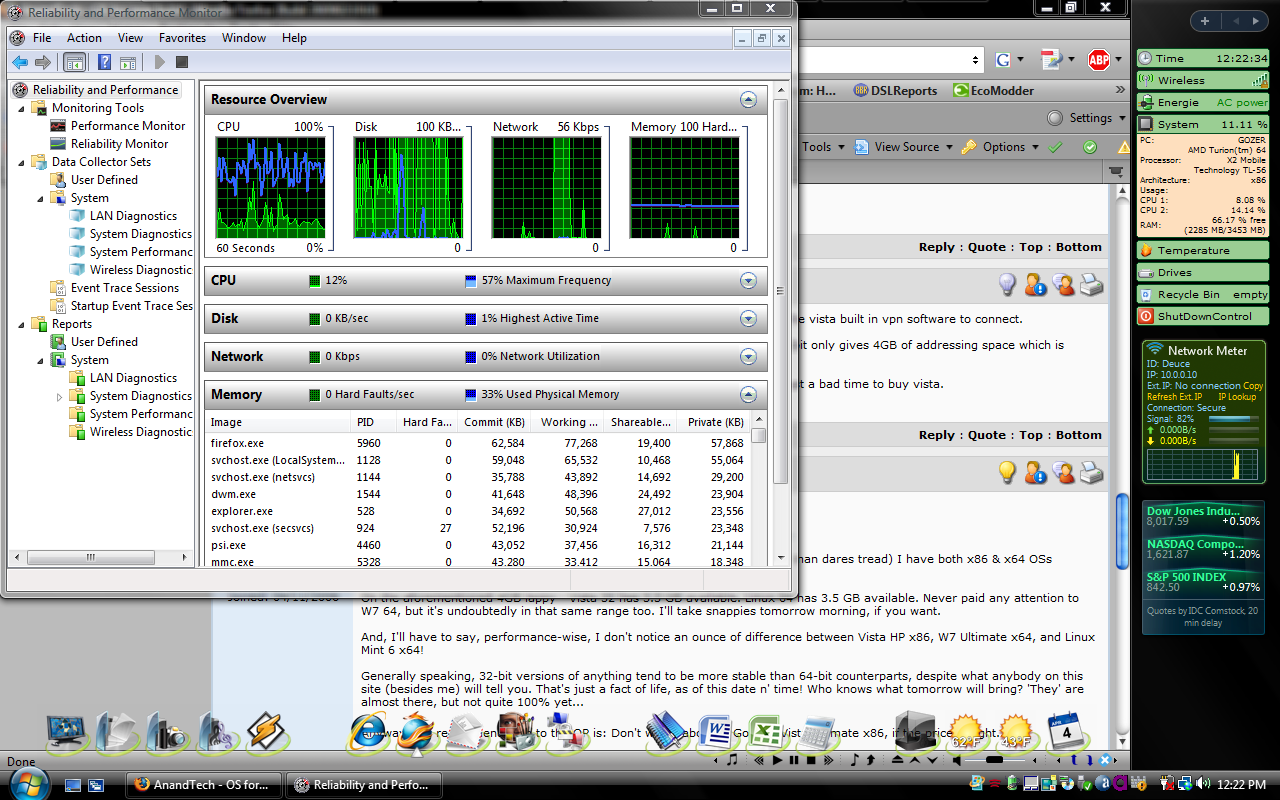

VinDSL
Apr 11, 2006
4,869
www.lenon.com
Originally posted by: Rockinacoustic
Thanks for the replies everyone...
I'll keep throwing programs at [W7] and update along the way.
That's what I do, sort of - I keep throwing OSs at my machines "and update along the way"... :D
I made some screenies yesterday, but I didn't have a chance to upload them to my server until this morning.
You might find this interesting, since you were asking about memory recognition (4GB lappy, multi-booted):
As you can see (on my Toshy) there's only a .3-.5GB difference between 3 different x86 & x64 OSs... ;)
