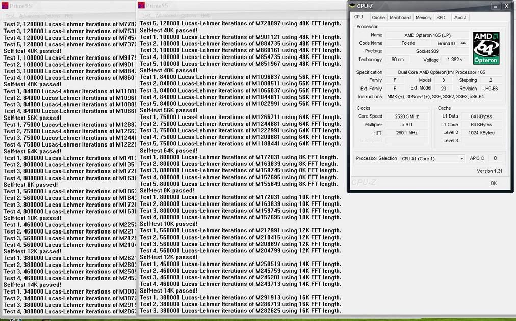

http://img.photobucket.com/albums/v167/trevor_r_C/2520Stable.jpg
Prime stable, 8 hours, SmallFFT test.
2520, 1.4v
Now, assuming how awesome that is, I should be able to get at LEAST 2.6, right? (Better than a 4800+, but I'm a greedy SOB and want an FX-60 >_>)
Anything near 2.6 or higher, Core0 dies on prime, REGARDLESS of the voltage.
