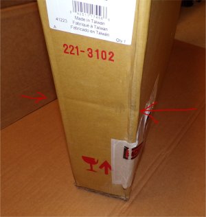

I have a 2009 Camry with a leaking radiator. So I ordered a Denso replacement from Rock Auto. The radiator arrived with a slight bend/twist to one of the end rails. The radiator holds pressure. Just wondering if this kind of damage could cause an issue in the future.
Dent on box that lines up with bend:
Here is the damage, front drivers side of radiator:
Top view:
Back side in the same exact spot, can hardly see any bend, I think that rail just twisted a little:
I used a straight edge, on the front side it's bent in a hair less that 3/32". From the back it's a hair less than 1/16". I think it just twisted the rail a little. One row of fins squished a little, only that one tube is affected. I also measured corner to corner, and it IS still square.
I'm afraid if I return it, the next one will be even worse. Aluminum is so easy to bend. Shipping sucks these days, they push these guys to deliver so many packages, they don't have time to be careful. And Denso does not pack these too well, about 1/4" on 3 sides of the radiator.
I've also heard Rock Auto sucks for returns. I did ask this question over on the Toyota Nation forums, and did get responses from two actual mechanics there, they say it will be fine. I would love more opinions before I spend a day and $50 worth of Toyota SLLC anti-freeze! Hate to have a leak later.
And yes, I got new Gates hoses, and a new Gates (Motorad) cap. Couple of clamps too, for the trans cooler lines, since the old bottom ones are a bit corroded.
Thanks for any opinions.

I would expect no problem. A minor bend in a tube is NOT an issue. IF that tube were partially collapsed at that point, or IF there was evidence of leakage, that would be different.

I've been screwed on a questionable radiator before. It had been a return to AutoZone. Started leaking after the first drive. Because of that experience, I'd send it back and get a new one. I'd probably try locally so you don't have to worry about shipping.
More than likely it'll be fine, but I'd worry about the seal down the road. The bend could cause uneven expansion went it heats up.
ETA: Honestly, after looking at the pictures again, I probably wouldn't worry about it.

That amount of damage is essentially cosmetic, though if it had been me I'd have sent it back for a replacement since I do this sort of thing for a living. Can't put that kind of stuff in a customer vehicle. Also a return with documentation might help the companies involved pinpoint where such damage is coming from (unlikely, but one can hope). For all you know, there might be thousands of boxes with similar or worse damage caused by a negligent operator somewhere in the supply chain.
