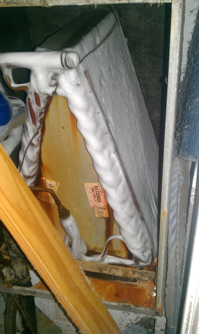

Although I will argue than my "frozen" problem from last night might turn out to be more expensive: Oops :p
Ouch. Well the evap coil is still doing what it's suppose to do: being cold. :biggrin:
Looks like its just low on freon. If you were around cincinnati I could top it off for like $150
I'm hoping that's the diagnosis. Fortunately, Dallas is under a cold spell right now - temps in the low 90s all week! :thumbsup:
If the fans working and your filter is clean the only other common thing it could be is that evap coil is dirty underneath. Low on freon is much more likely.
Yeah, I thawed it out, changed the filters, checked the fan, then turned it all back on. 2 minutes later, ice was forming again. :'(
