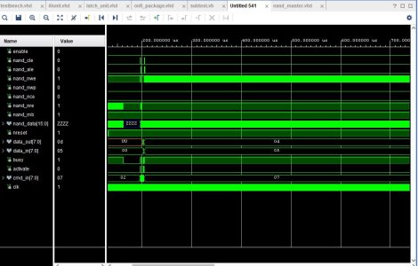

Hello.
I am doing ONFI 4.x interface with NAND flash onfi 2.2 compliant. The ONFI controller was downloaded from opencore website.
I made onfi 4.x comatiable with my target nand device. However, when I write 5 bytes (80h) into target device it does not end writing and continues....
I tried to edit file but I think its not allowed to make changes.
Can't we make changes in the file even if it's downloaded to my local directory in viavdo. it seems nand_master.vhd is connected to somewhere in the onfi website.
When I send a request to write (80h) it sends all the block, page bytes (8192) on the bus and it never ends. Technically, it should issue 10h after the 5 bytes of data_in write.
-- this loop don't make controller stop wrting
elsif(substate = MS_WRITE_DATA3)then
if(byte_count < data_bytes_per_page + oob_bytes_per_page)then
substate <= MS_WRITE_DATA1;
else
substate <= MS_SUBMIT_COMMAND1;
end if;
n_state <= M_NAND_PAGE_PROGRAM;
state <= M_WAIT;
-- It should do like this
elsif(substate = MS_SUBMIT_COMMAND1)then
cle_data_in <= x"0010";
state <= M_WAIT;
substate <= MS_WAIT;
Anybody know how to solve this issue so write operation should stop after writing 5 bytes and issue10h.
