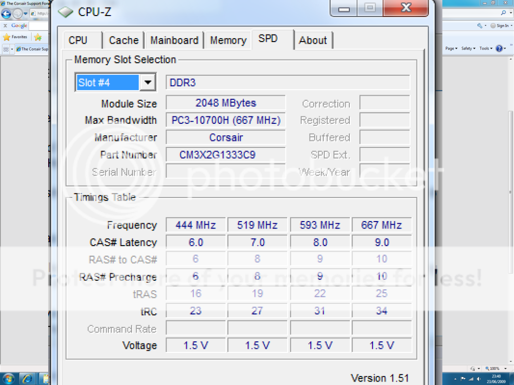

Hello guys,
I recently bought 6x 2GB Corsair XMS3 1600MHz DDR3 9-9-9-24 RAM (ref: HX3X12G1600C9). I understand that this RAM supports XMP.
My suspicions first arose about my RAM when the XMP option was not enabled in my BIOS. My MB is a GA-EX58-Extreme.
My system passed 9hrs of Prime and 2Hrs of Linpack
I downloaded and had a look in CPU-Z 1.51 and one of my RAM sticks is shown as 1333MHz without XMP.
Here's a screen shot of CPU-Z showing the stick in slot 1. Slots 2, 3, 5 and 6 are identical.
http://i429.photobucket.com/al...3/CPU-ZScreenshot1.png
Slot 4 is shown as something else:
http://i429.photobucket.com/al...3/CPU-ZScreenshot2.png
The sticks all looked physically identical when I installed them. I'm guessing that eBuyer.com may have slipped a different stick into my order by mistake (even though they were individually packaged but wrapped with a stickie label and elastic bands).
What do you guys think - is CPU-Z correct and I got one stick different to the others? Or should I try something?
Note: That I ordered the RAM on 17/5/09, so its just over 1 month ago (I only built the rig three weeks ago).

I'd suggest PMing Yellowbeard on these forums; he works for Corsair.
It appears you either got the wrong DIMM from another kit, or the SPD was incorrectly programmed.

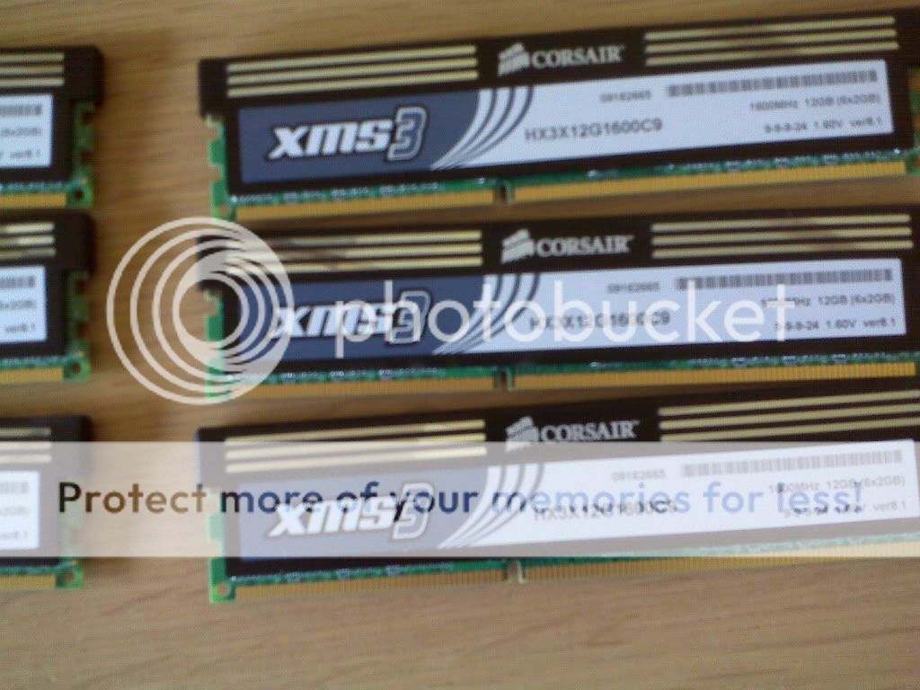

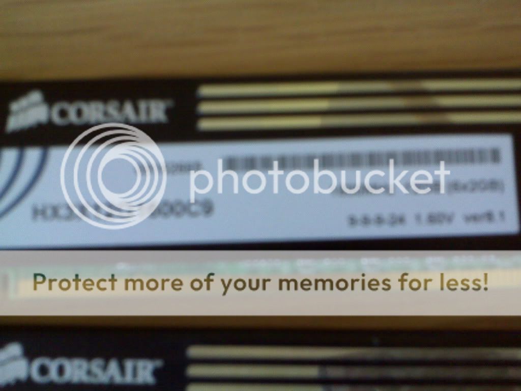

I took out the RAM and they are all physically identical (inc. product numbers).
http://i429.photobucket.com/al...wilson123/IMG00033.jpg
http://i429.photobucket.com/al...wilson123/IMG00035.jpg
http://i429.photobucket.com/al...wilson123/IMG00037.jpg
http://i429.photobucket.com/al...wilson123/IMG00038.jpg
Put all the RAM back in with the suspect module in slot 1 and CPU-Z reported that slot 1 had a different module. That module is definitely knackered.
Oh and the modules are seated correctly:
http://i429.photobucket.com/al...wilson123/IMG00040.jpg
I rang eBuyer and I've got a RMA number. Unfortunately they would not accept me returning just the defective module (what a PITA), so I have to return all six modules.
They will arrange for a courier to collect the RAM on a date and place of my choosing.
Since my PC will have no RAM in it, I've ordered some cheap and cheerful RAM to tide me over whilst the Corsair DIMMs are being replaced.
http://specialtech.co.uk/spsho...uct.php?productid=7326
I'll arrange for the Corsair DIMMs to be collected once the cheap RAM arrives.
It's good to have a spare set of RAM anyway in case I need to do testing in the future.

daw123
Aug 30, 2008
2,593
Originally posted by: Blain
Use Macro mode when shooting closeups. :p
The photos were taken using my Blackberry; hence crappy resolution.
