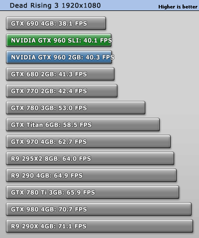

To start with, HD5970 only has 1GB of aggregate VRAM vs. 3GB on the 280X. In a lot of games that means slide-show and vastly reduced level of texture quality. If you intend to keep this card for modern 2015-2017 games, going with a 1GB card is not smart. Even with 2GB of VRAM, it's already not enough in some games.
10708
5970 would be crippled hard. Fallout 4 would destroy a 1GB card.

I wouldn't think running into a RAM limit would hamstring 128-bit cards like the 960 so greatly, though I'd wager latency probably plays a greater role than bandwidth.
