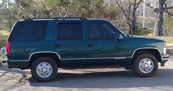

Saw what I think I want today. Short body Yukon with barn doors. Sucka' was super clean too. Not a scratch or ding anywhere that I could see. Four rectangular headlights above the parking/turn signals if that helps anyone with a year.
It was in a parking lot of a store and I thought it was a customer's so I didn't want to nose around it too much. When I drove back past the place a couple of hours later, it was still there so possibly an employee. Didn't have time to stop back in though.

The ones on my wagon have been pretty good. Only have had to replace them once. But I've been through three sets on my Sebring trunk and that trunk lid is heavy enough to do very serious damage if it falls on your hand.
If I find one for sale in decent shape that has doors, that's what I want. I don't drive enough for gas mileage to be an issue and I need something to pull a trailer with a 2,000 pound load on it.
I'd freaking LOVE to have the one I saw the other day. Or at least I think I would not having heard it run or knowing anything else about it mechanically.
I can't use a full sized one since my garage space is only about 18 feet at most. From the specs I've read, the full sized ones are closer to 20 feet and this one I saw should have been under 17.

I still don't see the fascination... 15 hwy fuel economy, granted my older SUV doesn't do long trips so it's the utility, not the fuel economy that maters.
The thing is, even if it's in a low rust region, a vehicle that age can require a lot of nickel and dime TLC and it's only nickel and dime if prepared to DIY.
If rust is off the table, it may still need suspension components replaced, many if not all fluids flushed, radiator, water pump, hoses, vac lines, wiring, etc. Not trying to discourage it but trying to get a vehicle that age ready for a new tour of duty can be an investment in time and labor as well as some money.
Barn doors? It's still the last thing that would be on my mind on a > 20 y/o vehicle. BUT, if it makes you happy to have barn doors, and it makes it worth the effort to semi-restore it, then you should have what you want.
193K miles though, I would never pay over $1K for any vehicle with that high a mileage, unless it was a diesel truck that size or larger, unless I had some special plan to reuse the chassis and do some resto-mod something. That does not mean someone else couldn't find value in it for $4K, depends a lot on the true state of wear of tranny and engine in particular, considering how much full sized trucks/SUVs cost today.
