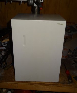

I still have one of these in the garage: (from a 2010 build)
1707856261026.pngO
I'd still be using it but it's not really built for today's AIO coolers I LIKE the low RPM 230mm fans...nice and quiet while still providing plenty of air flow.

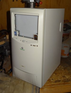

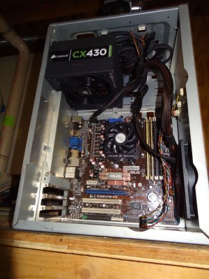

It's now about as done as it's going to get, until I get a chance to get some new parts in it and test/deploy that.
Here's what it'll look like if I use the front bezel... except it's not screwed on so there's a gap that wouldn't be there.

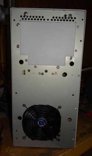

Here's with the bezel and filter panel off. Could just put the filter panel back on w/o the bezel and put the USB port on the metal wall. The bay blocking plate is a piece of plastic diffuser sheeting from a TV. The fan hole didn't cut as cleanly as I would have liked. I was too lazy to get out a finer toothed jig saw blade, so it was pulling the metal back and forth.

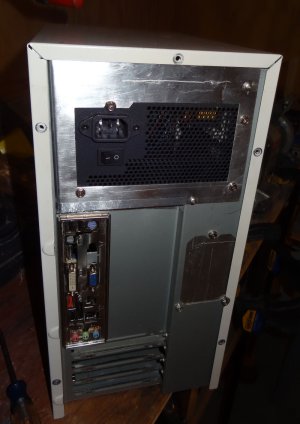

PSU Mounting Plate to provide a flat PSU mounting surface. The case wall that was there, was split like you see under the plate, all the way to the top, and original PSU was a tiny thing mounted where the patched cutout on the right is. I should have used thicker aluminum. It flexes slightly from the weight of the PSU so I put an interior brace tab under the PSU. The gap under it is sealed with aluminun duct tape.
Access to the right edge of the board is cramped due to the fan, but if a particular mobo or full length video card needs it, fan could be mounted on the outside wall of the case or 50/50 on a bracket, would still fit under the bezel if that's used.
