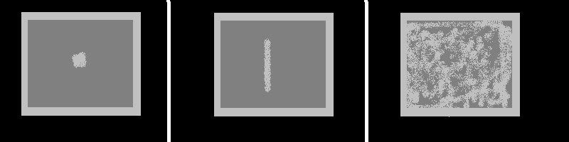

I have always applied it to the cpu as well. I guess most hsf manufacturers and even AMD applies TIM to the hsf, for whatever thats worth. I usually place a small dab in the middle of the cpu and drag the tip half way to each corner where I then place a micro dab. When i'm done it kinda makes an 'X'. After reading the article above from BR site, I am starting to think I should spread it out like you are.

Here is my guide that I wrote after some research: TIM Application Guide
The best way is to follow the instructions of the TIM manufacturer. I used Arctic Silver and Artic Cooling guidance to come up with my guide.
The horizontal line application doesn't work too well with the OCZ Freeze stuff. It's far too thick, strong and gloopy to do the whole finger in cling film spread technique, and a little too cumbersome for the horizontal line technique (though you could probably get it fine with a bit of skill). In the end I did as OCZ suggested and put only a grain of rice/half a BB's size of paste in the centre of the CPU, and let the coolers pressure do the rest.
Since moving to Intel Dual Cores, I've been using the Artic Silver method, and it's worked extremely well for me...I apply a thin line down the middle, and let the HS do the work. Prior to this, I ran mostly AMD without IHS, in this case I used a small amount directly on the core, and an old credit card to spread it out nice and thin. When I go Quad, I'll continue to use the AS method. I must also note, I do not use AS5, but some Shin Etsu that I have plenty of.
