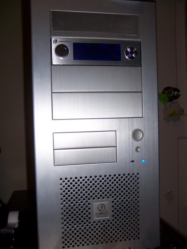

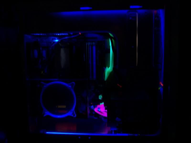

Riddlinkidstoner
Sep 3, 2006
272
Yes the rear is 80mm so I use a PCI blower combined with a 120mm side intake directly on my video card so it cools it no problem. 80mm is enough exhaust for me because my AC freezer pro blows it directly into it. 80mm top blow hole as well.
So for the PC-60 Plus II you have one 120mm intake and one 120mm either intake or exhaust on the side. 80mm rear and top blowhole.
http://i5.photobucket.com/albums/y168/Riddlinkidstoner/Computer013.jpg
http://i5.photobucket.com/albums/y168/Riddlinkidstoner/Computer002.jpg
http://i5.photobucket.com/albums/y168/Riddlinkidstoner/Computer001-1.jpg
http://i5.photobucket.com/albums/y168/Riddlinkidstoner/Computer004.jpg
