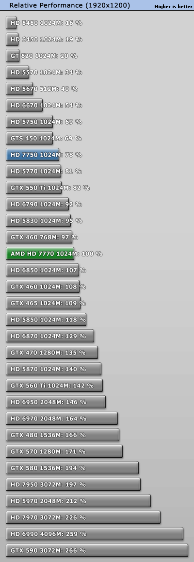

Can someone find one reason why anybody should buy the 7770 over the 6870, 6850, GTX460 1GB, GTX560?
No.
The 7750 however looks nice - not requiring external power is a huge deal. But the 7770 is just lackluster unless the price goes down substantially.

7770 = 6790 w/ DX 11.1 and lower power consumption. Might do well to crossfire them if you can snag a good deal.
Err, no.
The HD 7770 is 10% faster than the HD 6790 as it is now. Now, these are new cards on a new architecture, so take into account their performance will improve by a good amount in the next one-two months depending on how aggressive AMD is with their new driver releases. When that happens the 7770 will be only be ~2-3% slower than the 6850 and around 15% faster than the 6790; now that I look at it the HD 6850 is definitely slightly faster today. With new drivers the HD 7750 will be going from a tiny bit slower than the 6770 to a tiny bit faster.
As it stands now the HD 7750 is a direct replacement for the 6770, but the 7770 will only be a direct replacement for the HD 6850 for most people one-two months from now.
