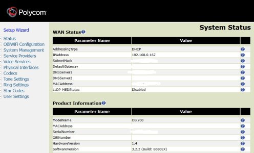

Very doubtful that this will work, but if you have an Obi/Polycom adapter that's not working with Google Voice you can try a firmware update. OBI 20x latest firmware or 3rd party firmware. To find out what firmware version you have first log in to your router to get the IP address of your adapter If you can dial out, you can also dial ***1 to obtain it. I have a TP Link router and I found it under Advanced-Network-DHCP Server-DHCP Client List-Assigned IP Address-Obi200-192.168.0.167.
I entered 192.168.0.167 and logged in to to my Obi200 with the default login admin, password: admin. You can change the password. My firmware version is 3.2.2 (Build: 8680EX). This I believe was the last available firmware version for the Obi200. You can update the firmware from here under System Management. Can you use the Setup Wizard to get a new/used Obi/Polycom adapter up and running, again very doubtful??
