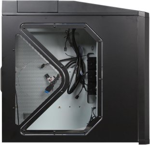

Does the case have a large perforated, non-filtered area on the side panel?

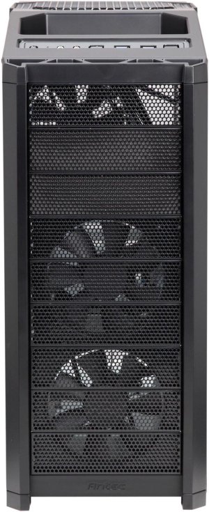

I'd be inclined to make the top fan a filtered intake fan, not wanting negative case pressurization to suck dust in through the side panel (and every other hole/gap/crevice, fouling the case USB ports too), and then add filter material to the front bezel large-hole mesh because it doesn't look filtered either?
If it's not a high powered gaming system, I'd rather delete the top fan than having it blowing out, as the other fans are plenty for just a typical office class build, unless it's going to have a boatload of HDDs in it.
I'd need the case in front of me to measure, to know more. For example rather than a top fan at all, for a gaming system, I'd rather put a blocker panel on the side panel mesh, with a hole sized for a side intake fan, and filtered intake there for the video card.

Yep that's the beast, same side window exactly as seen. None of the fans or side mesh have any dust filter. This PC had uncommonly little dust internally. So little I mentioned it and owner said he and wife have allergies so they have a couple allergen-rated air cleaners in their house, including his entertainment room. So I'm not concerned with dust.
