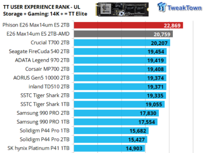

At least one PCIe 5.0 SSD also working faster on Intel platform.
Hmmm...AMD needs to look into this seriously.
Hail The Brain Slug
Oct 10, 2005
3,490
2,419
9% performance loss with AMD chipset.
It's not really the AMD Chipset at fault here, AM5 thus far doesn't offer PCI-e 5 on the chipset. It's down to the PCI-e 5.0 implementation in the IOD on the CPU.

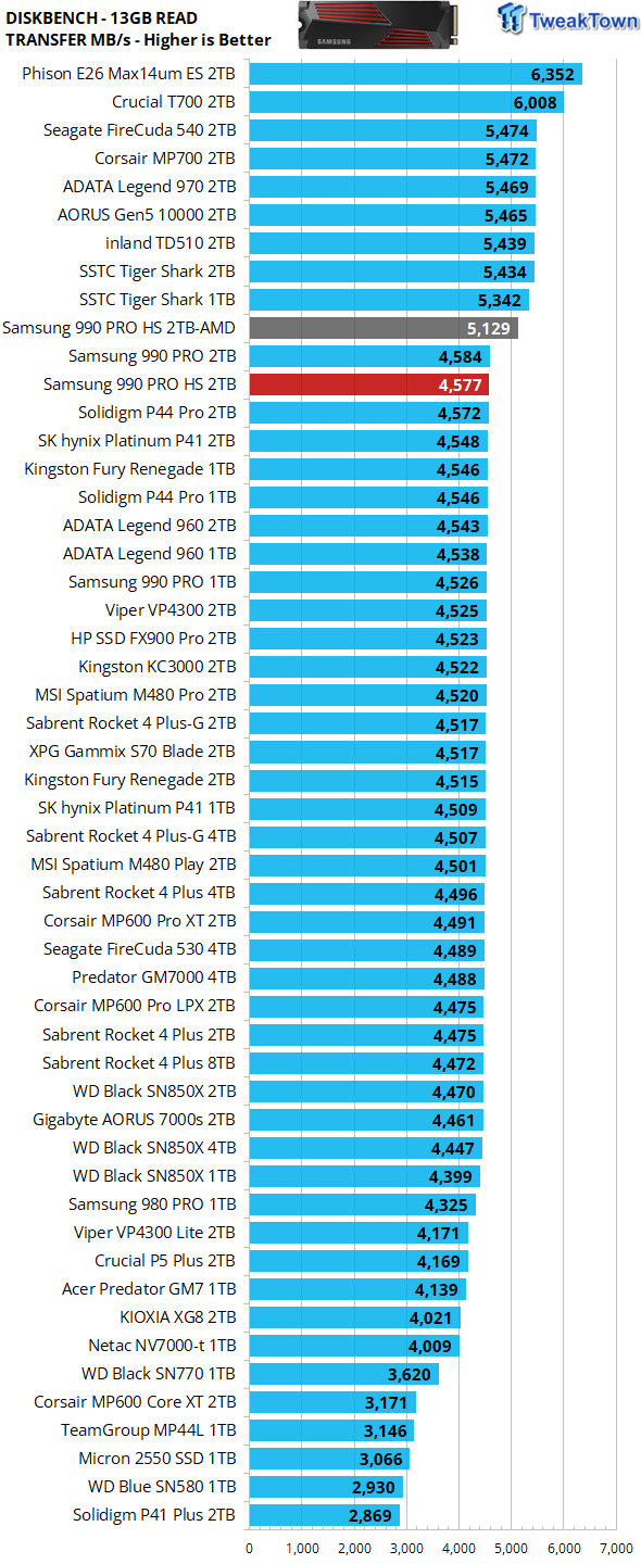

Even weirder are these PCIe 4.0 tests: here is 990 PRO 2 GB with a heatsink. AMD & Intel are neck and neck in almost every test, except:
12.3% lead for Intel
12.1% lead for AMD
