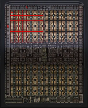

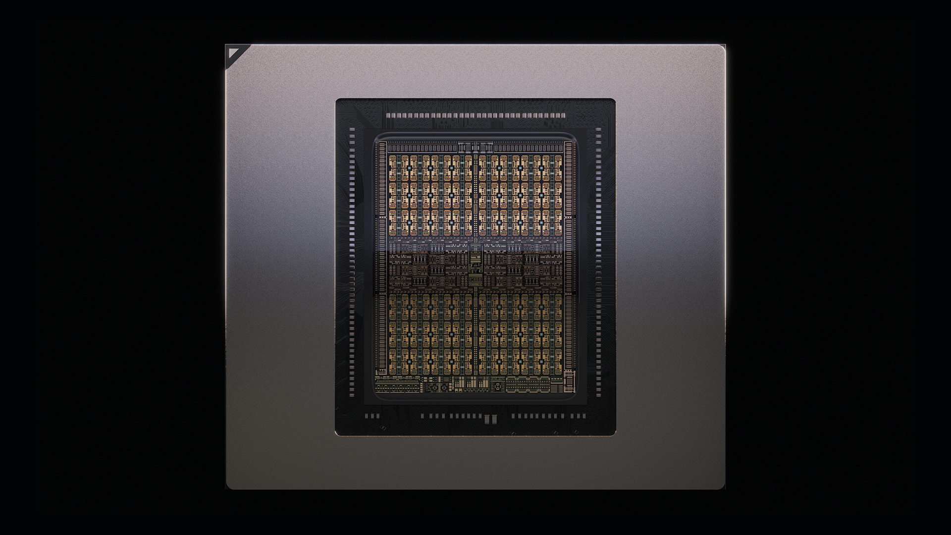

I didn’t see a Rubin thread, so I’ll post this here:
It looks like Nvidia are pre-announcing what I’m guessing is the professional version of what will likely be the same die as the RTX 6090, especially since it employs GDDR7 memory. I also count what appears to be a 512-bit memory interface:
Looks like 16*12 to me.
Unless NV is trolling, but that SM layout looks different. So same SM number but way bigger.
Assuming the same number of everything as GB202 with a clock bump to ~3.1Ghz, you can achieve 30PF of sparse FP4 with 6x the FP4 throughput of Blackwell...
For reference I expect AT0 to be a bit over 5PF sparse FP4, leapfrogging GB202 and nothing more, investing the rest of the area gains into things that actually matter.
So yeah, way bigger systolic arrays. Nothing about the diagram looks like 256-288SM and there is no way it is 384, so 192 is my bet with the info we have.

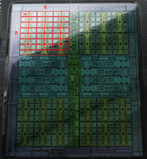

We know GB202 is 12*16 as is visible here.
288 SMs? Looks like an additional row on each side vs GB202View attachment 129893
Good catch. Yeah, it looks like in terms of rows*columns at each quadrant, Blackwell was 8x6 while Rubin is 6x8. Same number of SMs, just a different aspect ratio.
Blackwell:
Rubin:
Hmm... guess Rubin is what I thought Blackwell would be... AI all the things. I am not sure how this will translate to gaming performance. The higher clocks will help for sure.
Think doubling or more of tensor cores.
Blackwell:
Rubin:
Interestingly, on these Die shot visualizations Rubin CPX looks more like a gaming GPU instead of a datacenter GPU. Very close to AD102 and GB202. And in the press release they said availability by end of 2026, which would also align with the next gaming card release cycle.
So my questions would be:
  • Could it really be, that Nvidia massively increases tensor core capabilities in GR102 and re-uses it in datacenter?
    • Would also make sense for PCIe based accelerator cards and RTX Pro
  • Does this include only FP4 inferencing or all tensor core data formats?
  • Does this also apply for the smaller gaming GPUs in the Rubin line-up?
