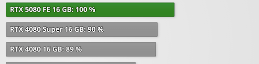

"RT is more memory hungry so it benefits more from larger cache and memory bandwidth
It's didn't help to 5080 vs 4080, despite 4080 have 76 RT cores, 5080 84 and higher memory bandwidth
11% only
4070 have 46, 5070 have 48
Heartbreaker
Apr 3, 2006
5,229
6,857
11% only
Some people really failing to read.
That Quote is NOT mine, it's the previous posters assumption that I was shooting down.
It's even in the sentence, you had to crop out, in your quote of me...
You should direct you reply to him, as that's his quote.
