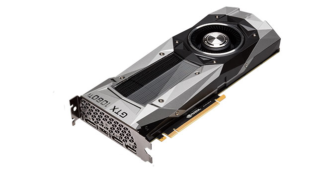

Again if we normalise prices like they were before the 2000 series, the RTX 3080 is about 30% faster than RTX 2080ti, which is in line with GTX 1080ti over GTX 980ti and GTX 980ti over GTX 780ti.
GTX980Ti over GTX780Ti was 40% at 1440p/4K
GTX1080Ti over GTX980ti was 75% at 1440p/4K
RTX3080 over RTX2080Ti is just 30% at 4K
This is the worst new gen on a new node after Fermi.

Yup, let's compare the $700 GTX 1080Ti with the $1000 RTX 2080Ti and the $1500 RTX 3090....
Macdonal combo meal is $8, pretty sure it was only $6 a few years ago. Have you look at the price of housing? Cell phones? Not to get political, but official inflation number is bs, it's so much more expensive for many things.
