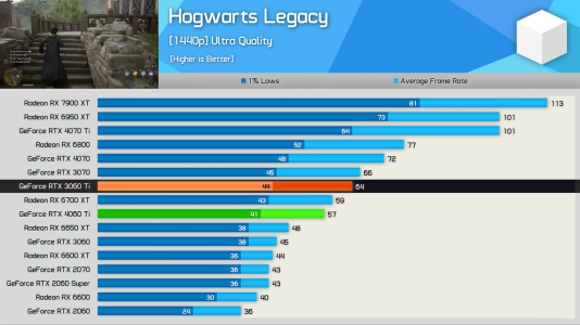

NVidia was claiming 15% uplift over 3060 Ti, which was fairly awful to start with, but it's more like 9% at 1080p, and 5% at 1440p. That's pathetic. The cache isn't doing a good enough job covering for the loss of memory bandwidth. They really failed on the technical side here.

I agree. This is mainly held back by Memory Bandwidth, and the 16GB won't fix that. 16GB will only fix the few outliers where it runs out of VRAM.
This should have been a 192 bit bus, with 12GB (or 160/10GB at the bare minimum), and it would have been quite decent for $400.
