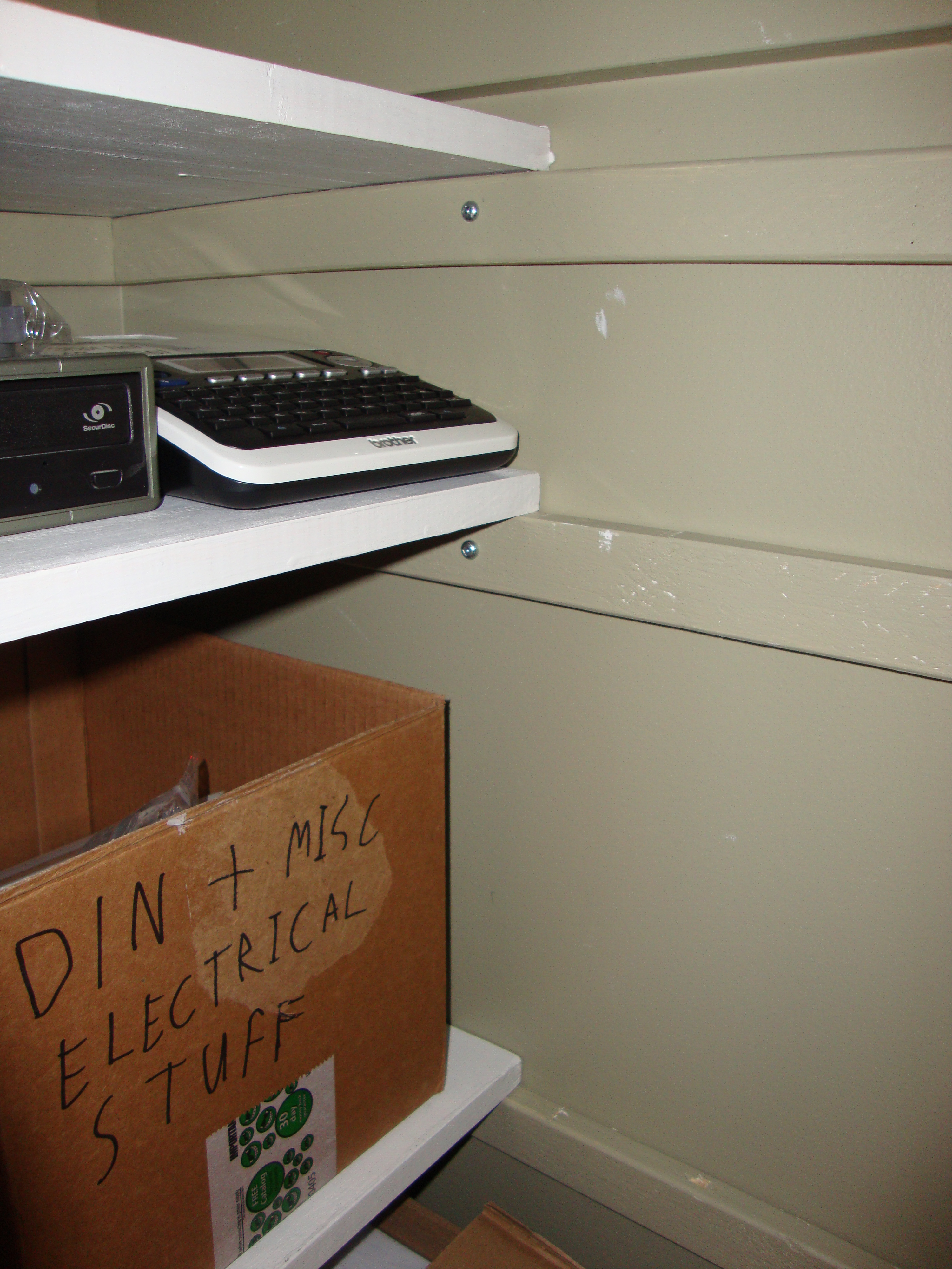

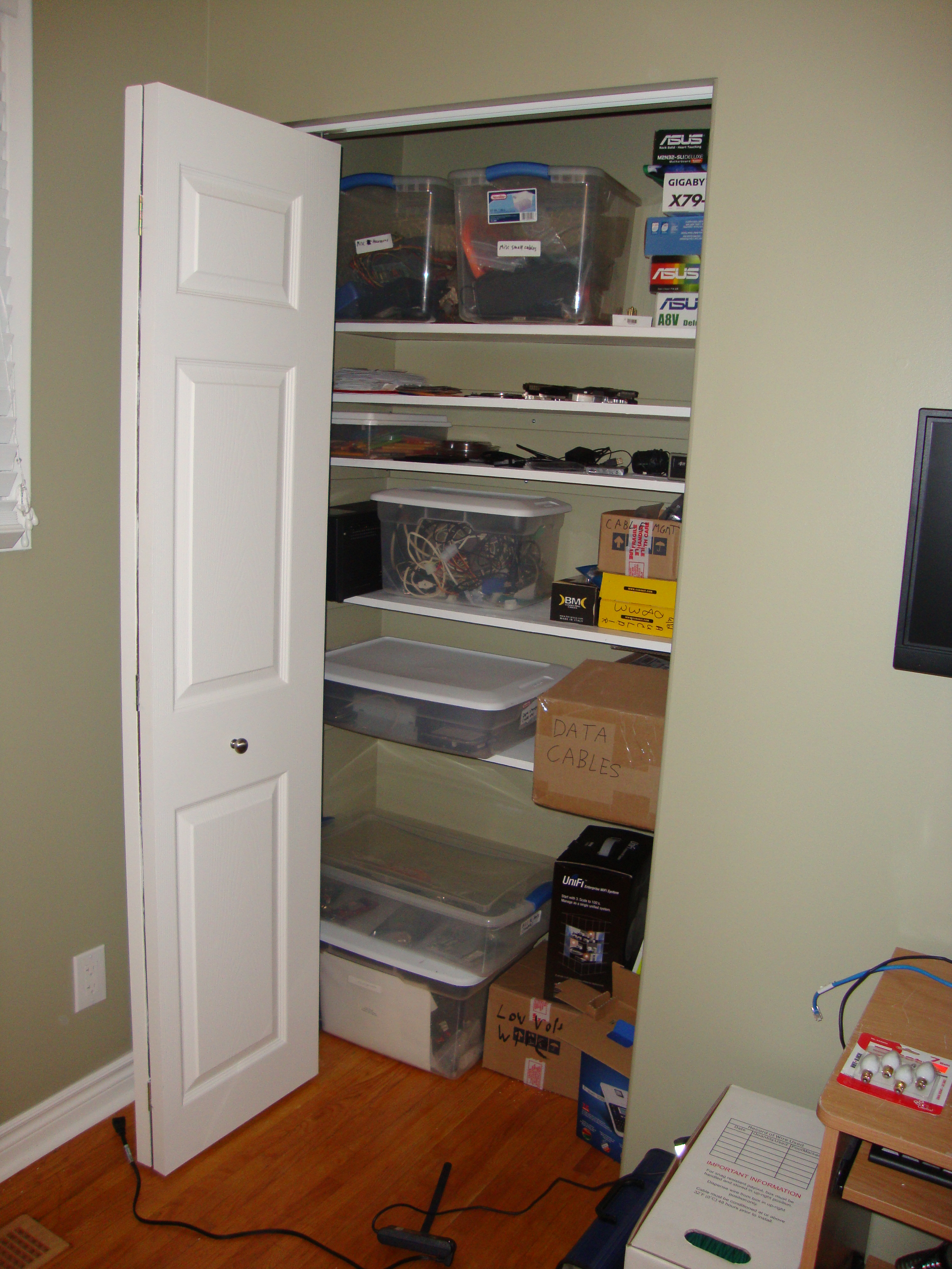

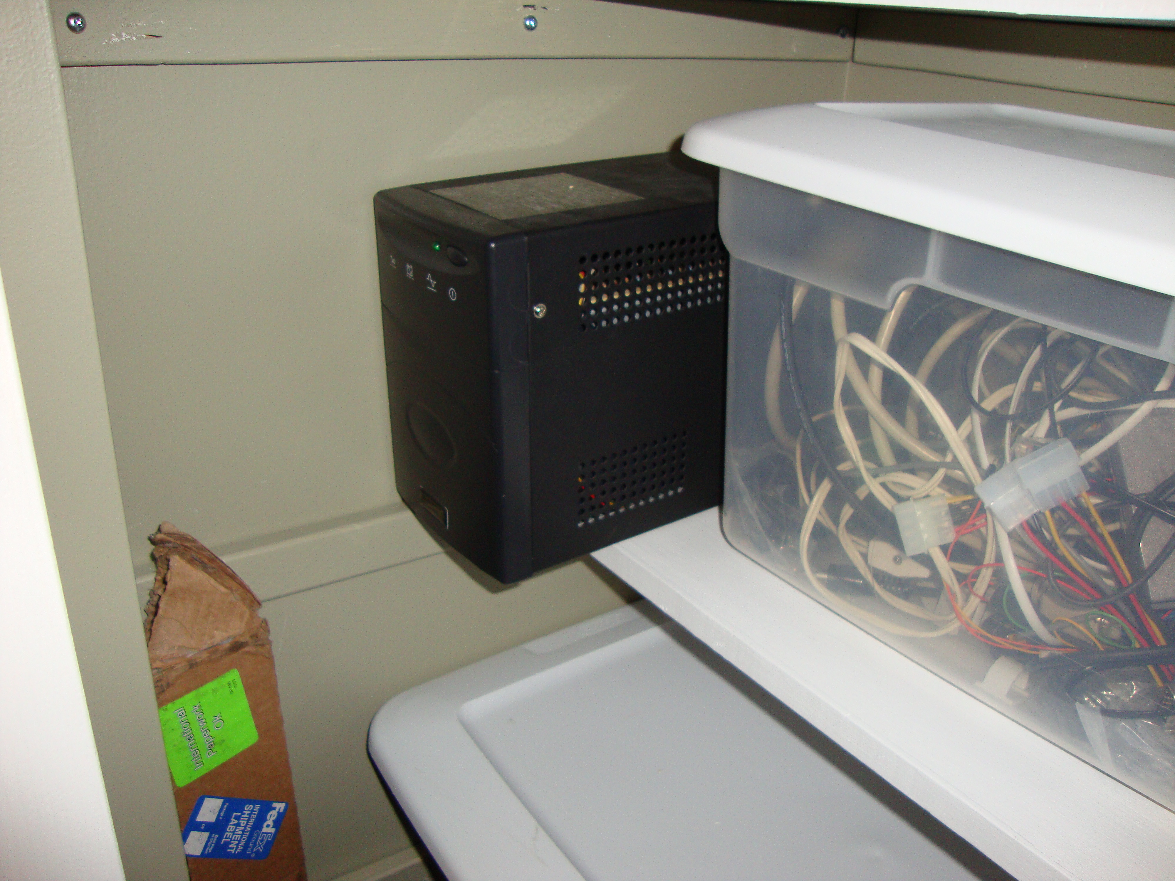

Stud finders are your friend. Locate them throughout the closet, use 1x2 pieces of wood screwed to the studs horizontally as shelf holders and pine boards for the shelves, very solid. You could even use 2x2's instead of 1x2's and screw the shelves into them as well if you want overkill. Good if there are kids that are likely to try climbing as with loose shelves they could flip.
Had a bit of trouble getting some of those shelves in, hence the stuffs. But it ain't going anywhere. Was a couple day project, mostly due to waiting for primer/paint to dry.
Could also install those adjustable rail systems but I find they can be flimsy. It's nice to be able to throw a UPS or big ass battery on there and not worry about weight.
