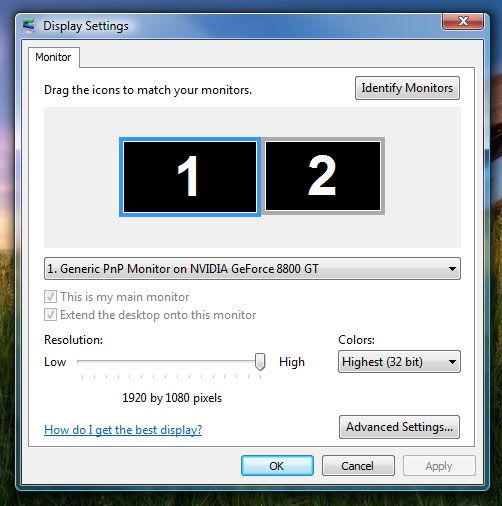

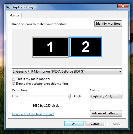

I'm using Vista 64 and an 8800GT. The process I used (images to help):
1. Connect DVI -> HDMI cable to 37" 1080p HDTV (plug it into the left-most DVI output on the card, when looking directly at it from behind the case). Set as primary display. That's how it's defaulted as your `primary.'
2. Connect DVI -> DVI 22" LCD (plug into the right-most DVI output on the card when looking directly at it from behind the case). Set as "2" and set "Extend my desktop onto this monitor."
Display Properties for Display 1
Display Properties for Display 2
3. Set the resolutions as you wish on each display.

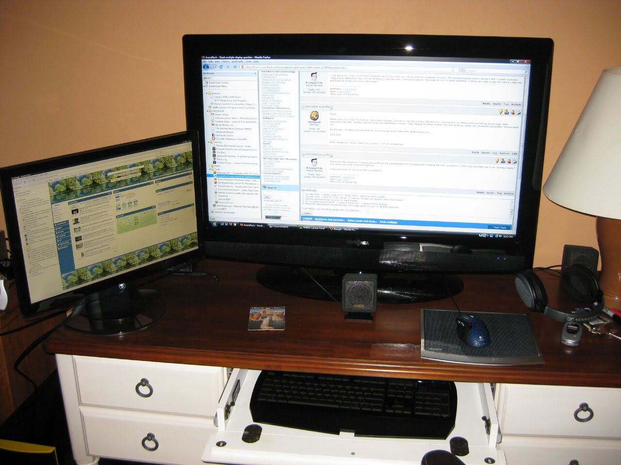

37" 1080p HDTV (primary) & 22" LCD (secondary)

What are those black-colored devices you have shown to the left of your large monitor?
They appear to be some sort of router/switch device?!
