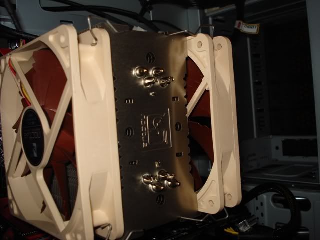

On a semi-related note, I would REALLY like to see pictures of how you got the heatsink + fans to fit over the top of Trident RAM sticks. I thought from the space issues that Tridents would basically be out of the picture.
I have several on my camera, I'll get them uploaded when I get home.

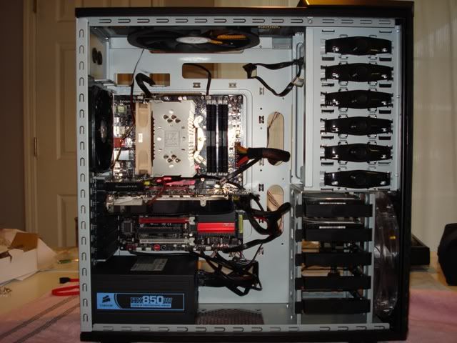

I noticed you have first fan offset on the top by about 1-2 inches. I would say lose the ram cooling and put the fan on correctly -- there will be more cooling towards the BASE of the heatsink, where all the heat is coming from in the first place. The second fan is just an exhaust and not cooling off the heatsink as much as the first one, so this would probably help by a large margin (even if it's not responsible for your very high temps).
In regards to the RAM cooling, just fan to blow cool air into your case from the top, as you have a PSU on the bottom. It will be running right over your ram.
If you don't care for that you could also orient the heat sink to run north/south instead of east/west.
