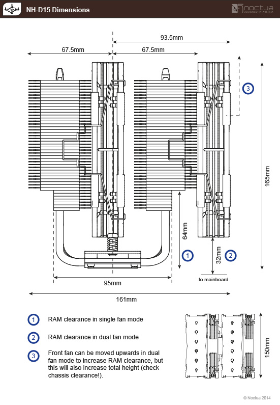

The question is, the Noctua NH-D15 might not fit with my G-Skill Trident X 2400Mhz. If I take the memory fins (detachable), it comes down to 39mm. Noctua says the NH-D15 have 32mm clearance for memory. I can't raise the fan (it will barely fit my Carbide 300R, with 170mm clearance).
But here is the catch. The Dark Rock Pro 3 also states no room for the Trident X at 35mm memory clearance with the fan centered, but it fits: http://www.tweaktown.com/image.php?...n_terms_of_performance_and_quietness_full.jpg
How? Because people say the CPU raises the block 8mm and the memory slot raises the memory 3mm approximately. If you do the math, you have 5mm extra to fit the memory.
If this is correct, unless the motherboard of the TweakTown test is different from all the rest, I am assuming the Noctua NH-D15 will also have extra 5mm on top of the 32mm it states. The TweakTown photo seems to attest to that. Then I can spare a millimeter or two according to a guy who says the Dark Rock Pro 3 leaves 5mm to spare from the side panel of a Carbide 300R (I have the same case). The Noctua is slightly bigger, but it will have a couple millimeters to spare as well.
I know the Dark Rock Pro 3 is a safe bet and it can handle 4.4Ghz, but I hate to pass on a real performer like the NH-D15. And I might even try to run it with 4.6Ghz, which the Dark Rock Pro 3 might not handle properly. Sometimes I do video rendering and the CPU usage gets pretty high.
Anyone with a Noctua NH-D15 that can attest 37mm clearance for the memory? Or maybe Noctua states 32mm already taking into account the 5mm extra? I am not sure.

I have the Noctua NH-D15, and I had to raise the fan to get it to fit over the TridentZ DDR4 modules that I have which are 44mm tall.. But your RAM has detachable fins, so you might be able to squeeze it in.
Another option is to use a single fan in the middle, or get the NH-D15s which is specifically designed for greater compatibility..
Adjusting the fan is very easy, but I can't say off the top of my head whether yours will make it or not for sure..

They measure from the board and include the 5mm bump:
With my 30.5mm Mushkin Stealth ram, the front fans on my D15 sits 5mm higher than the middle fan. Could go a little lower. Barely.
As suggested, can run the D15 in single fan mode with a modest 1-3 degrees increase in temps. Or get the D15S.
But this data is at odds with the FAQs, which states RAM up to 32mm. If they are measuring from the board it has to be RAM of 29mm (subtracted 3mm from the memory slot). I wrote them. I just expect they give me a response based on a real test bench.
If you have some 5mm to spare, there might be another 5mm extra to the side panel of my Carbide. I'll research people with D15s and 300Rs. If I do the math with my 9900NT, will be a gamble of 1-2mm. But yes, if it does not fit, maybe it is better to use one fan for now or replace with a 120mm one (the N15S is not available here). I just let go of the DRP3. Too warm in comparison with the competition and it is not that quieter than the N15.
Ah, I misread your quote before. I thought you had 5mm to spare. It makes sense with the review of OC3D, when his low profile Vengeance 29mm makes the front fan a little bit higher than the middle one. It would not fit a 39mm RAM in a Carbide. Funnily enough, Noctua replied saying 32mm RAM is the actual clearance with RAM slots into account and everything. I knew I could not trust their response :)
