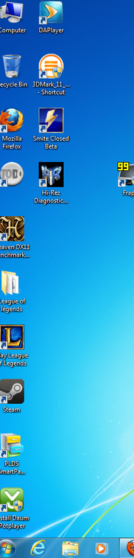

I did notice some of the ghosting, but I can live with that for now. I'm having another issue which am sure is a simple fix, but I just can't seem to find how to do it. I tried messing around with the screen resolution but I can't seem to fix it. My friend suggested that is because the VGA cable?

Hook it up to a TV with HDMI if that is working and look at the BIOS. I dont know why it would not work via VGA/DVI. Maybe look at the bios or try using the lowest setting on you video card/ Integrated video. I have seen some video cards stet to black letters on a black background. Or try safe mode with video support and change the settings.

The edge of the screen being cut off can often be fixed by pressing another button on the monitor :)
(Re-sync or re-scan or something like that)
Pro-tip: throw away the VGA cable. Never be tempted to connect it again.
With DVI, Windows should detect the native resolution of your monitor and auto-adjust it for you. If not, don't "mess" with the screen resolution...set to the native rez manually. If the edge cut-off is still there, Dave is correct...find that button.
