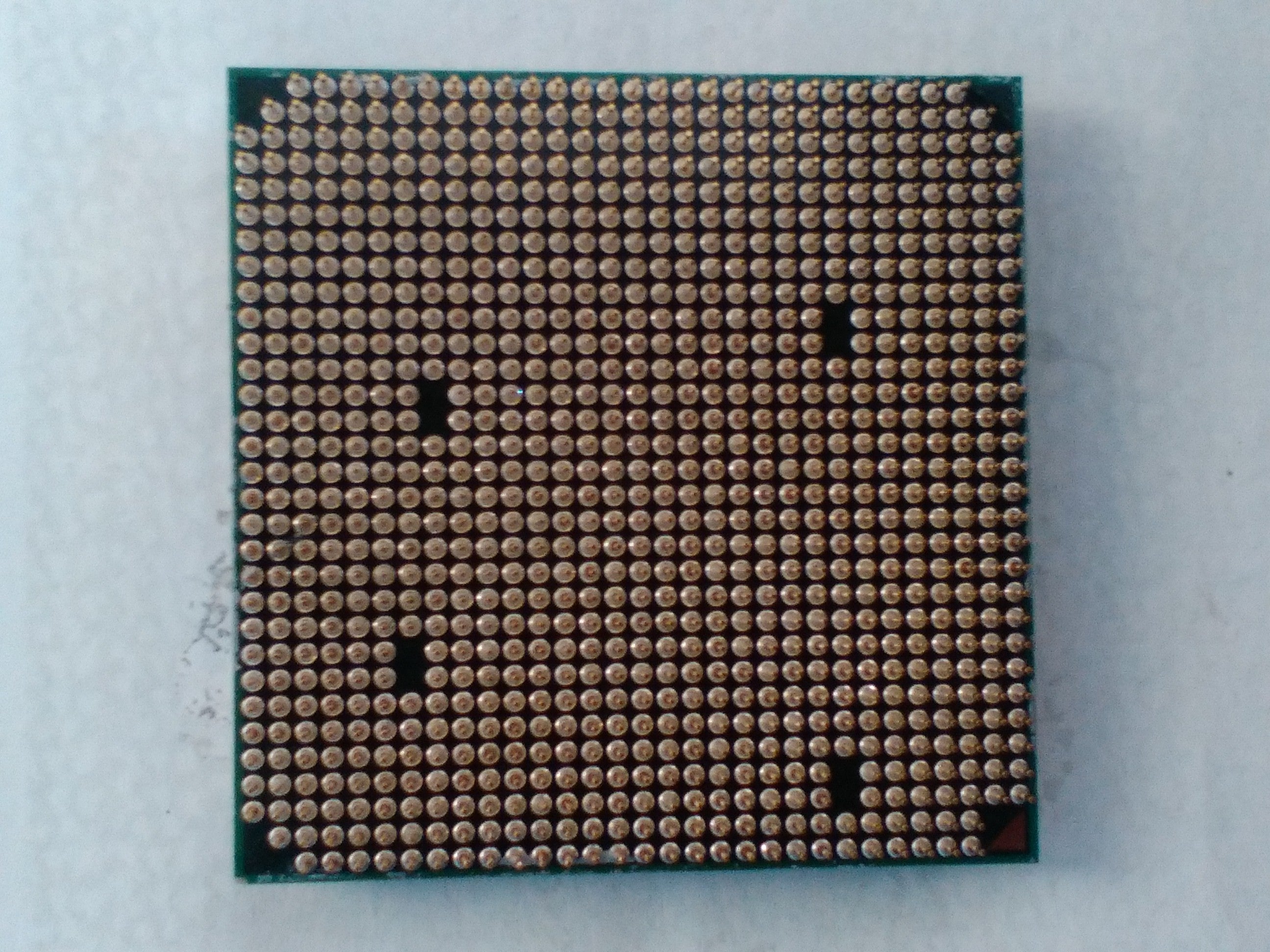

When I rebuilt my computer I got no video no beeps, nothing. I already tried CMOS reset (with a battery and also CMOS jumper). I went minimalistic and removed everything from the motherboard, there is only PSU connected and CPU. I have installed speaker and I still get 0 beeps when I power computer. I added 1 stick of RAM and still nothing. This computer worked yesterday.
So now I have 0 idea what to do next.
